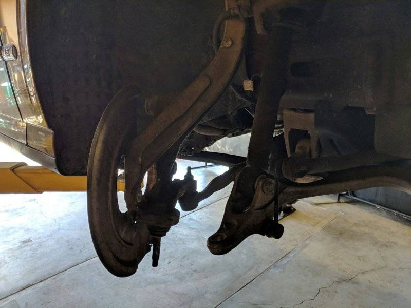

    Got a front right suspension squeak/creak that is hard for me to pin down. 2000 V6. It makes a loud creak when hitting bumps or turning the steering wheel or even when braking and releasing the brakes. I have replaced the lower ball joint and the upper control arm/ball joint. Seems like when I put the car on the lift (2 post lift so the suspension sags) the noise will go away for a day or so then come back. Would this be the outer tie rod end, lower control arm bushings, shock?

    Look for torn boots on the contol arm bushings. Spray each pivot point with some lube... one at a time,,, on all suspension parts and take a short drive with each individual one you spray. Lower shock mounts too. It's a process of elimination. You could also check for proper bolt/nut torque on all the components.

          Just wanted to follow up on this. Turned out to be a bad lower ball joint. I had replaced this ball joint with a Moog one and it made the same creak as before so I was sure that it was not the sound. I got fed up with the noise and pierced the ball joint boot then lubed with lithium grease in a spray can. All is quiet now. I have another new ball joint waiting for me to install when this one starts making noise again.
