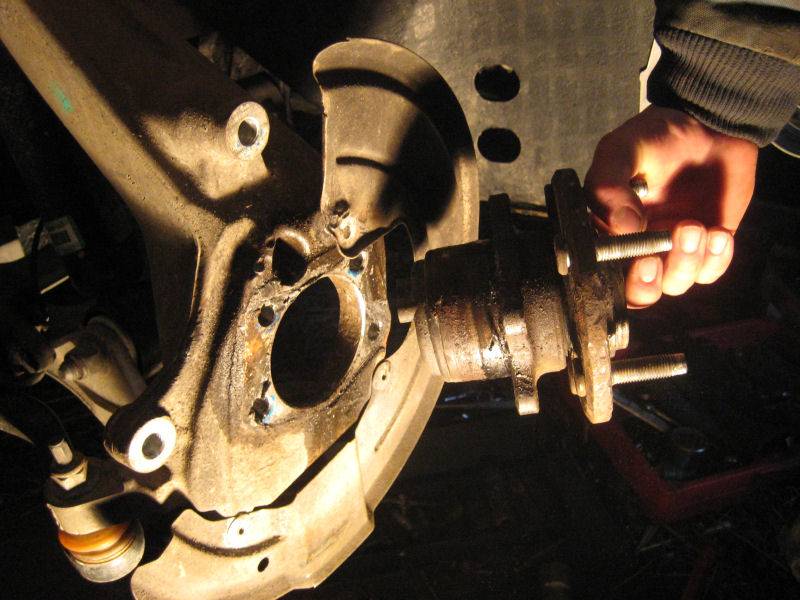

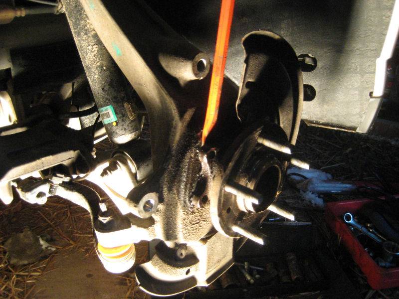

How I got the front bearing Assy Out
First of all, the reason the bearing assy is so hard to remove is because the aluminum arm fuses to the rusted steel bearing assy.
Without any fancy tools you must use chisels and a hammer to slowly pry the bearing out and away from the aluminum arm. Once there is some separation, you can spray WD40 or any other lubricate. You must use the chisel and hammer and work all the way around the bearing assy as to evenly separate the bearing assy from the aluminum arm. Don't second guess yourself as to how hard and long it will take to remove the bearing assy; Hit hard! and it will take about a half hour to get it to pop out.

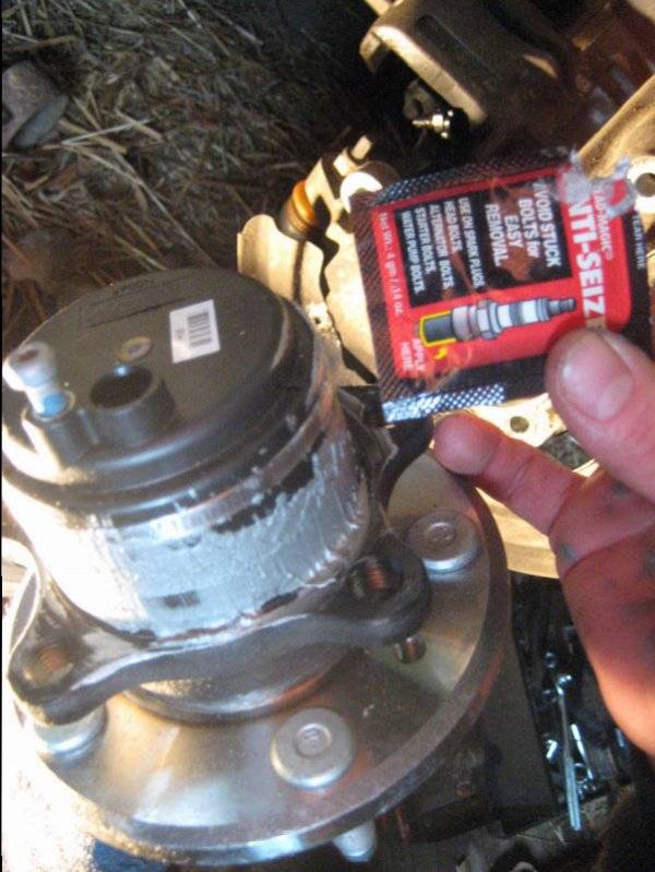

Before you put the new bearing assy back in, put some anti seize on the rim so next time it should come out easier!

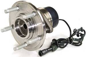

New Bearing Assy Pic
Here is a picture of what you get when buying a new front bearing assy for the Lincoln LS....

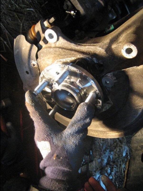

Putting the new bearing assy in.....
Here is the final pictures of putting the new front bearing assy back in. :D

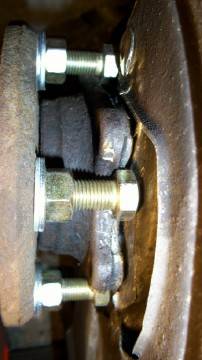

Removed the five wheel studs.
Bought 5-1 1/2 inch long 7/16 inch dia. fully threaded bolts, 10 washers and 5 nuts.
Installed the nuts fully on the bolts.
Placed the two washers on the bolt (against the outside of the nut).
Placed each of these, washer end first into each of the stud holes (thread end fist through the stud access hole in the knuckle, into the hub stud hole)..
After installing all five (they are a tight fit when passing the bearing flange), I positioned the hub so that each bolt head would bear up against the knuckle.
Loosened the nuts so that the bolt head pressed into the knuckle.
Slowly loosened each bolt, separating the hub from the knuckle.
The bearing fought the whole way out but it did come out.
