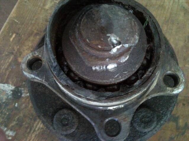

Thanks for all the help. It was the right front hub. I installed a Timken from rockauto.com and it solved the noise issue. It drives so much better too, it must have been bad for a while, it was all rusty inside. It took quite a long time to get it off, ended up using a torch since it was bonded to the arm.
