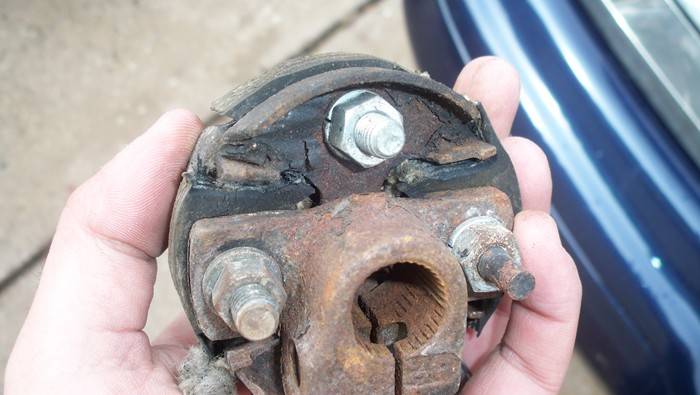

Why do you think? Ways to check if its damaged?
I dont feel a particular free play...

OEM bags should take care of any issue.
If not replace the steering joint.
It's a nice upgrade no matter what the reason is.

You can tell if it is bad by looking at it.
It looks like this.
