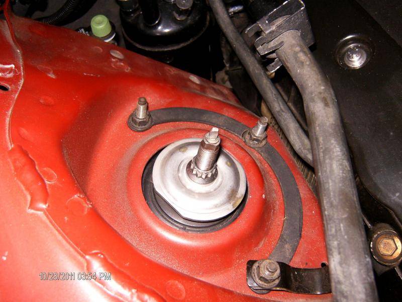

This next picture well there was no install instructions at all in the kit. some other kits mention to the position of the lettering on the spring. i have no clue if it applies here. I looked at KevIIIn's pictures from his conversion. his appear to be in a different location facing a different way. If someone can confirm the issue of matters or not i would be greatfule
this was it finally in. sadly it took 3 hours to compress both springs and put them together and then get the drivers side installed.
all in all im very excited to get things to work out. after i got the tire back on. i did a little trickery with the air ride and a jack to get the car to pump back up. the car was sitting for almost 2 weeks. the front was slammed 100 percent and the rears looked a hair lower then mormal.
i turned the air rid on and the drivers side solenoid was disconnect. instant fail on air ride so that was not an option to disconnect that. so instead what i did was jack the car up a little bit until it closed the locks on the driver side and starte pumping the passanger side. once that clicked it levled out the rears. i turned the air ride off and called it a night. it was 1130 already and im sure the neighbors were over the hammering trying to get a special little bolt out of its hole. anyway ill post some more pictures later for you all to critizie about how dirty my engine bay is right now and how bad the paint is. and of course how i scuffed the pretty blue on the bottom the shock. which kinda made me sad. but meh. life goes on.
Didn't come with one. hmm interesting. This is why i post random pics because ya never know what kind of **** gets over looked.
Sucks i just came from the junk yard too i could of easily grabbed a set of those washers. all well. i ended throwing 2 washers on each one. the front end is done i didnt take any other pictures yet. the car is so dirty and dusty from just sitting for the last two weeks its horrible i feel ashamed like i neglected a child or something.

The fronts are finished and the car is drivable. I ended up throwing some regular washers on the post. 2 on each side. now that the weather is cooler ill be at the yard more often and next time i go ill see if i can snag a proper set of t-bird washers for the upper mount.
