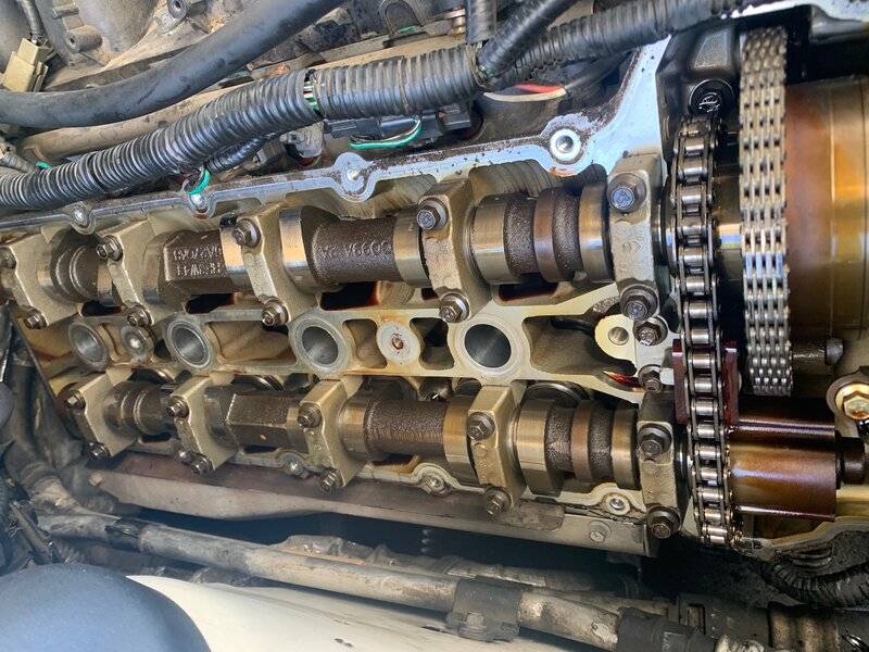

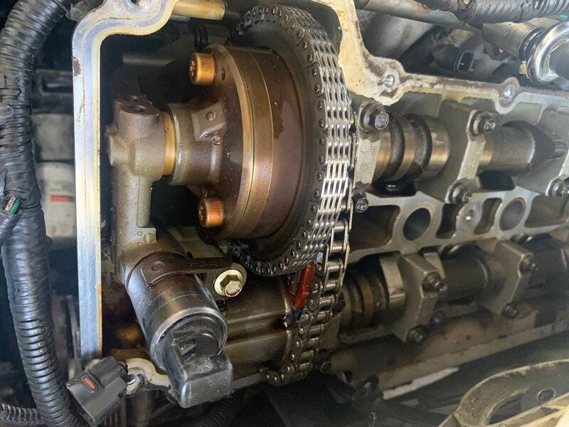

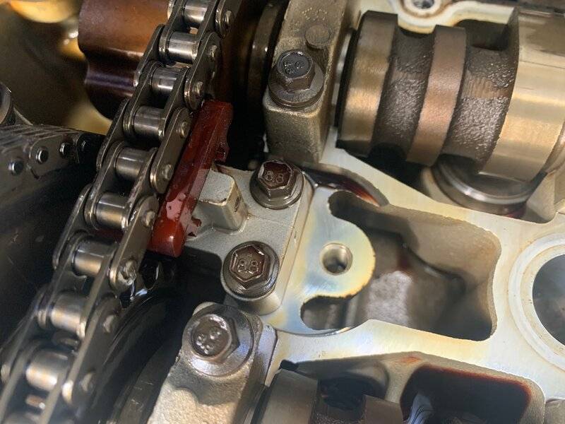

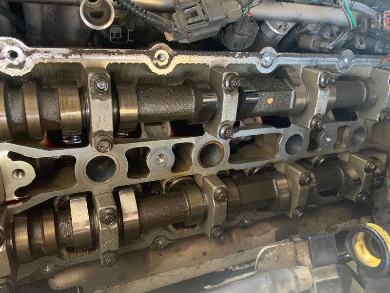

Here's how the cams and chains look. I am actually quite pleased with how they look. The secondary tensioner seems to be in good condition with no signs of wear.

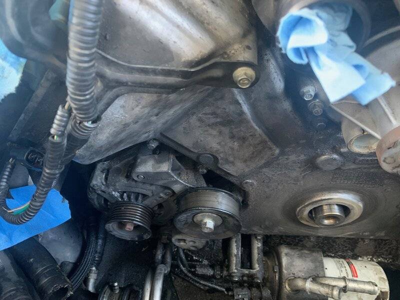

The front cover is another story with oil caked on. I'll be working on that tomorrow and also examining the primary tensioners and guides.

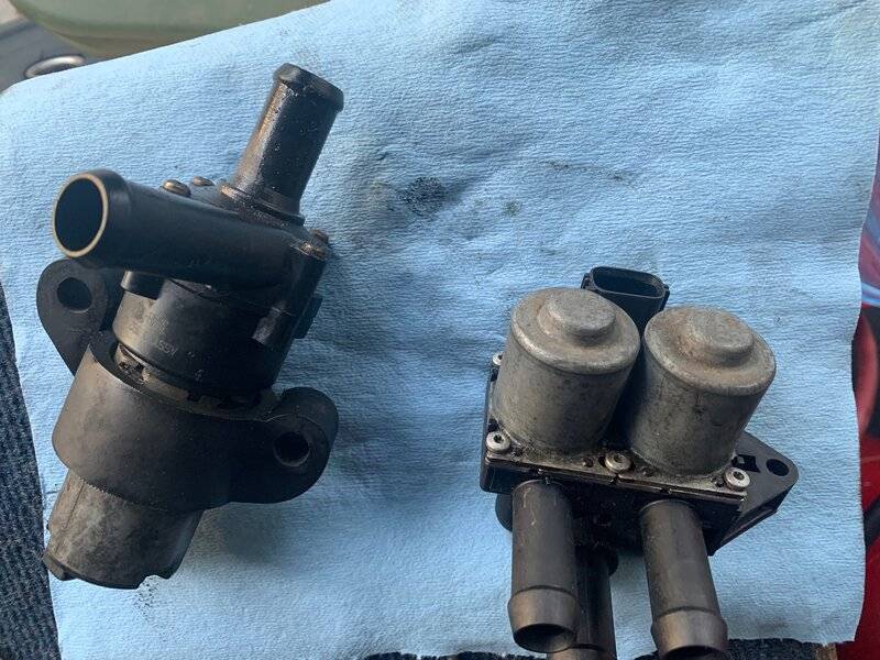

Here are also pictures of the auxiliary coolant pump and DCCV valve. I will probably go ahead and replace those. I didn't see any apparent cracks or damage to the radiator but I will give that a good look tomorrow. Maybe I should get it pressure tested...that's a thing, right?

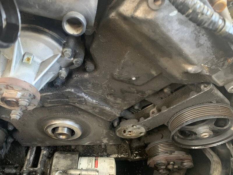

Front cover is off...what a pain getting the PS/tensioner bracket off. I've done that before but don't recall it being so difficult. Now just waiting on gaskets. After 280k miles, the tensioners, guides, and chains look really good. I didn't see any cracks or gouges. Looks like they got it right the second time (meaning in the Gen 2 engine).
There are some dark oil spots on the inside of the front cover, should I worry about those? I cleaned the outside really well, looks almost new. Now to attack all the oil muck from around the engine. I know better than to spray it with a hose. I did carefully squirt some Purple Power degreaser on the spots and plan on coming back with some brake clean.
...There are some dark oil spots on the inside of the front cover, should I worry about those? ...
I wouldn't. At anywhere close to 300K miles, there are going to be some spots like that. Places where the oil doesn't circulate much (where it doesn't need to) are bound to get a little stained.

Getting the PS/Tensioner bracket back on is a chore. Having learned my lesson, I always finger the bolts as far as they can go. I even sprayed brake clean into all of the threaded holes to clean out the gunk and really cleaned each of the bolts. Irrespective of how the manual articulates the process, I'm not sure they really thought about how all the different parts come off since they assemble most of the engine outside the car.
It's also a bit nerve wracking (possibly a mild overstatement), e.g., making sure right amount (3mm) of RTV in the 8 places for the front cover and valve covers are mounted within their 4 min time frame. I have no idea how they expect all 24 bolts of the front cover to be installed and appropriately torqued twice within 4 mins. Then there's getting the valve cover bolts and new gaskets are installed in their right places and the thought of "I hope none of the spark plug gaskets fell off" when I was putting the valve cover on.
