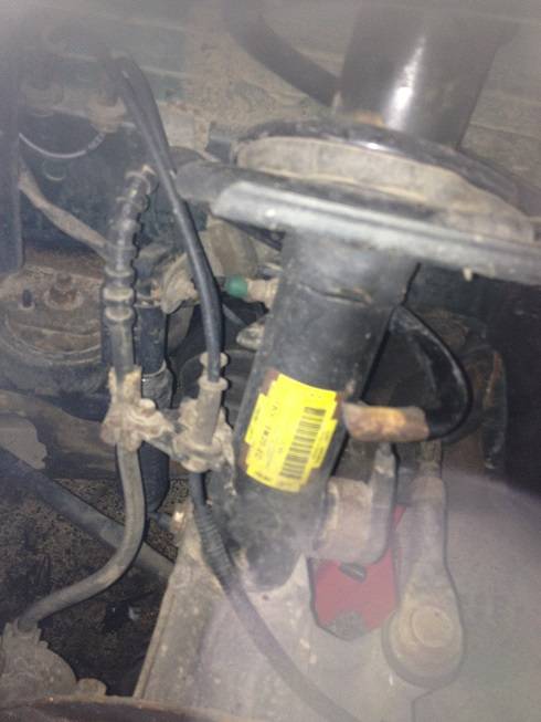

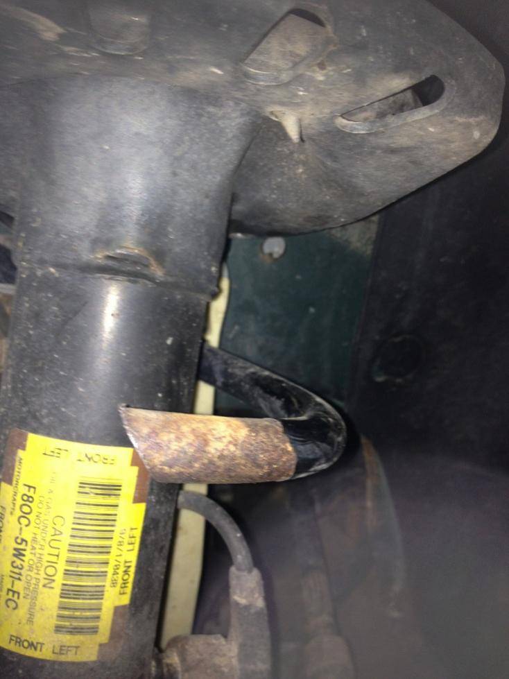

I sat in my car the other day and heard what I thought sounded like a coil spring twang. When I went to pull out of my garage my left front tire went flat immediately.
After taking the tire off I found a broken coil spring sticking out of the sidewall of the tire. My question is, can I simply replace the coil spring surrounding the strut, or do I have to replace the entire assembly. I've look through Rock Auto and have been able to find the coil spring with with or without the strut.
I have attached a couple photos to help explain what things look like. Any advice would be most helpful

You probably won't find just the spring available new but you might be better off buying the whole assembly used from a lower-mileage car from a non-salted area of the country. Buying just the spring means you'd need to rent a spring compressor to put it onto the strut.
Spring compressors are cheap $19.99 everyday or less, and I use my impact wrench to make a fast job of it. You have ride control then you will need electronic struts from Ford. Rockauto.com has this listed MOTORCRAFT Part # ASH1248 {#AA478, YF3Z18125BA}
