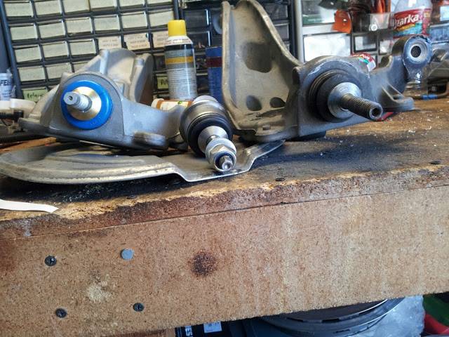

Here are a couple of comparison pictures. On the left is the complete Mevotech knuckle, in the middle is the "OEM Jaguar" ball joint from eBay and on the right is a MOOG.
The Mevotech and "OEM" use spring retainers for the boot on the stud end while the MOOG has a molded fit. The "OEM" boot fit very poorly and would slip down, likely permitting debris to enter the ball.
The MOOG joints failed on both sides after 26 months and 20,000 miles - sport suspension, stock wheels. Symptoms were squeaks when turning and suspension travel. When unloaded, the joints felt and moved just fine. One side had a "crunchy" feel to it so was obvious. The other side had me fooled.
I just installed the Mevotech on one side and a MOOG on the other - update in another two years?
Out of the box, the MOOGs move freely and smoothly. The Mevotech was slightly locked up, but freed with a little persuasion then moved easily. The "OEM" - notice the parts store hardware! - was completely locked up and took significant effort to free. It is still very stiff. There are no markings at all on that joint, so no idea who actually made it.
The "OEM" is, as one would expect, too good of a deal to be true - $50 shipped for both sides.
