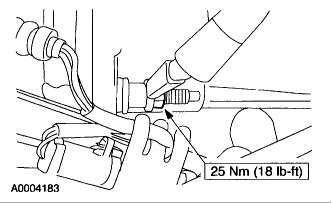

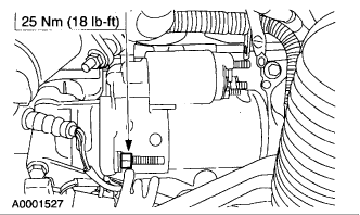

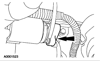

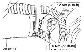

I would assume it's standard operating procedure as other starters. But being the ls, there's gonna be some stupid bolt that's tough to reach.
REMOVAL
1. Disconnect the battery ground cable.
2. Raise and support the vehicle.
3. Disconnect the ground strap.
4. Remove the cover.
5. Remove the nuts and position the cables aside.
6. Remove the bolt, stud bolt and the starter motor.
INSTALLATION
1. To install, reverse the removal procedure.
