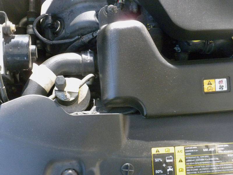

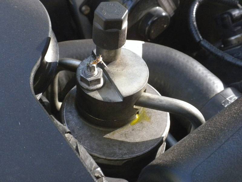

Didn't want to start a new thread to just get a confirmation of a possible leak I am seeing today. Is this a leak of refrigerant oil from the AC drier/receiver? I doubt it is coolant. Just trying to confirm before I take it in to get repaired.
Green???? Looks like it.....
On that radiator hose just past it, is that white residue around that molding mark? Looks like mine right before the rad hose started leaking there.
