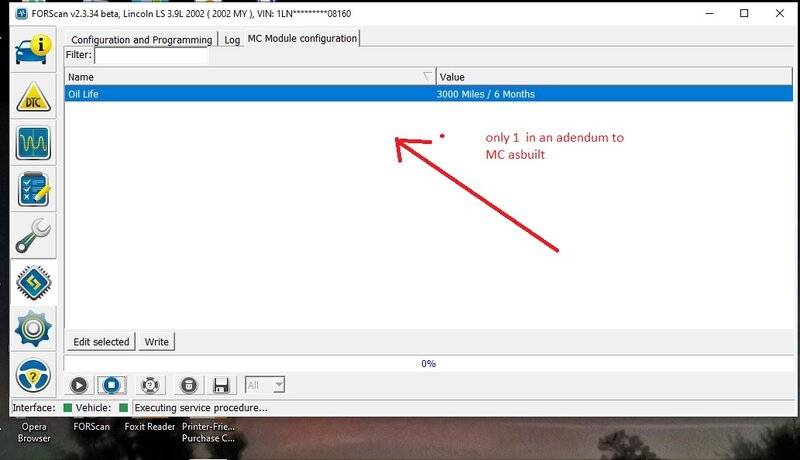

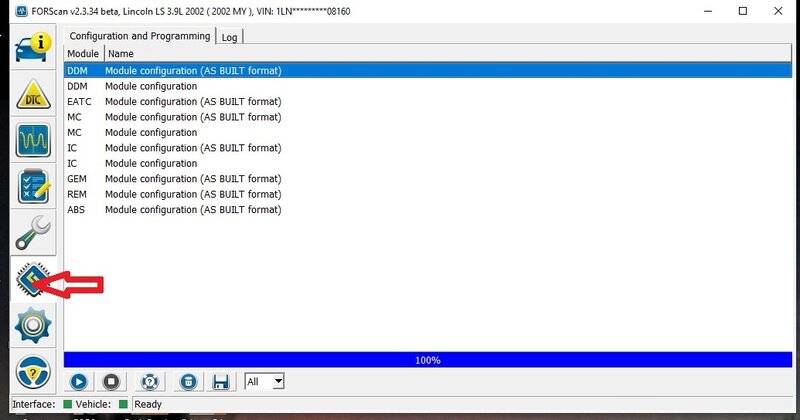

yea i got the forscan app up on win 10 laptop but im wondering where the beef is concerning module preferences there appears to be the modules but not very many options the options are in two module addendums for simple changes like oil time left .... what i was hoping to see was more options lists in each modules .... anyone to give feedback will help concerning gen 1

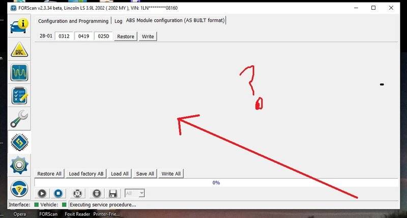

like ive backed up modules but there only 1k in length which makes me believe there are problems with capturing the files for re load in case of emergency ....

Forscan is really based on Model more than make...F-150 F-250 F-350 has many more options and features that can be used by Forscan ...you need to Google the Forscan Forum and research, research, research and the research so.e more in order to learn how to run this program...

My 2014 Fusion has dozens of module config lines. My 02 LS has as few as my 97 Taurus did. I take it to mean there simply isn't much to alter. Makes sense: more crude computers, no actual export, less bus usage, very few changes between trims, etc. Its nice for V6 owners that don't have the message center to change settings like autolocks and easy entry

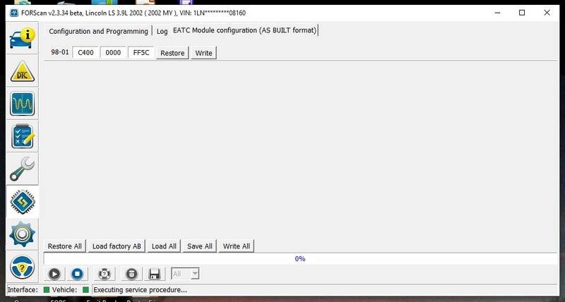

if i look at the asbuilt data in the asbuilt data browser there is the string but not sure if i can edit if i knew what the spreadsheet for the module was then there might be some angle
