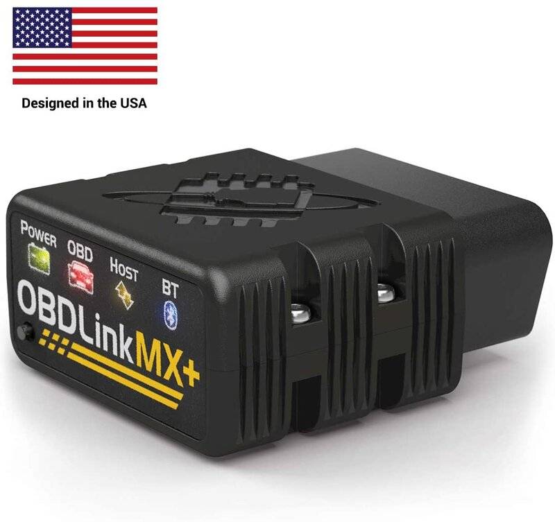

I would avoid the cheap knock-offs for trying to go wireless.
https://www.amazon.com/gp/product/B07JFRFJG6
I have been using this one for a few months with 0 issues and it has circuit protection built in that won't fry your pcm. It works with forscan and forscan lite with 0 issues. Also, this is the one forscan recommends to use.
They say this one is ok as well if you use an android device. But I would go with the first one if you can swing the difference as it has it's own app that is pretty good. Plus the first one works fine with a PC using forscan.

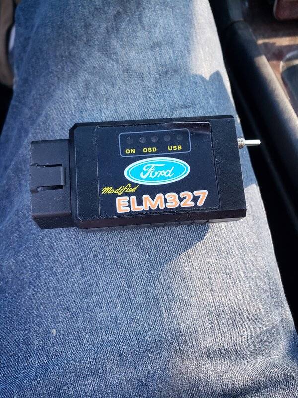

Anyone here ever use forscan or forscan light? I bought this adapter here but it thinks my car is a 1.8 liter focus instead of a 3.9liter Lincoln LS, is that just cuz it's the forscan light? I've been holding off on paying for forscan cuz it doesn't work right. Any ideas? View attachment 828575718
Try flipping the switch and plugging it in again. Mine did the exact same thing, it just isn’t in the right mode.

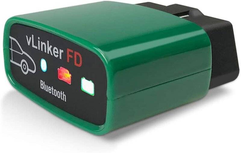

I sent it back and got the green vlinker one, works great now!
Having one with no switch that does it automatically is so much easier I am sure, right?
For sure, I don't know know how to use forscan very good yet, my laptop plug one has a switch, but I've never needed to switch it yet, lol
