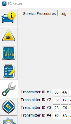

Gen 1 can't program fobs without a scan tool. Forscan, an OBDII adapter, and a Windows laptop made quick work of it for me. I was honestly surprised by the ease since I've seen a dealer struggle with another LS. Total time was only about 5 minutes from plug in to disconnect. I did use a wired adapter, didn't try with a Bluetooth one
something along the lines of connect to the car, connect to the PATS module specifically, run the connection, pick Fob programming? If I remember (and I usually don't), I'll look tonight to see the exact steps it takes. It's somewhat intuitive once you get used to Forscan's clunky interface

Pretty sure it would be to the DDM, not the PATS. PATS - Key, DDM - Remote
You're right, it's not the PATS. I was thinking it was in a PATS section, but they're tied to the specific physical modules (keys - instrument cluster, remotes to ddm).
Connect to the car, go to "Service Procedures" (wrench icon) and you'll see DDM Keyless Entry. Click to highlight, press the pay button at the bottom. That will then show you all the remotes programmed. It just shows a hex code for each, so it's easiest to just erase them all and program one at a time. It will recognize duplicates
