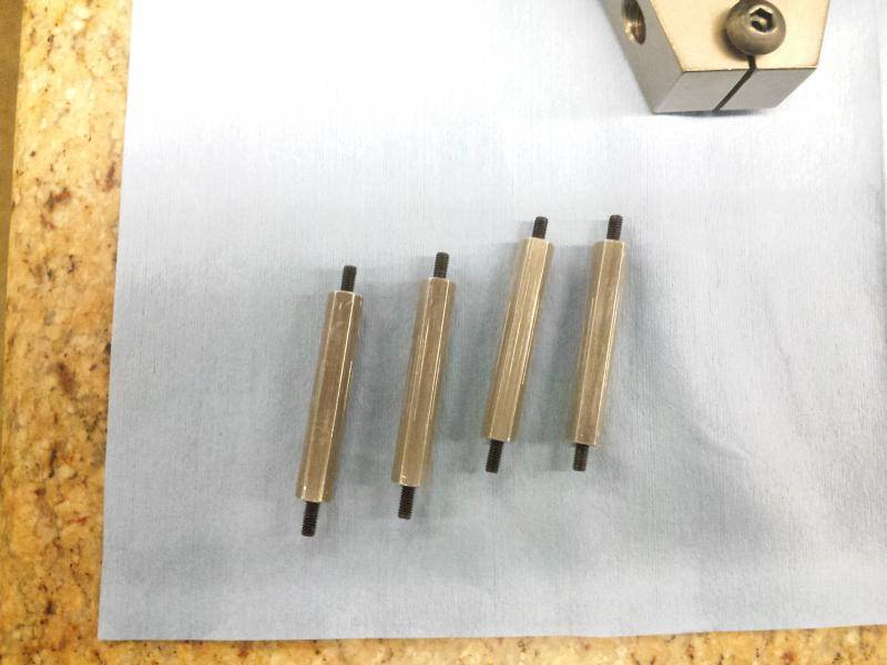

If i wouldn't have cared about warranty on mine.
I would have changed the plastic standoffs to aluminum with thread coming out of the top to go into the faceplate.
Something like these.
You, sir, must reside in my mind. That was the set-up I was looking to create (I am an A&P mechanic with access to sheetmetal and other goodies).
