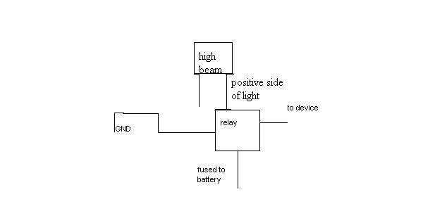

Are you wanting the fogs on with the high beams? If so your are going to need a relay. There was a post on how to do this a couple months ago.

A relay and some wiring would do it.

here's you a crude schematic
