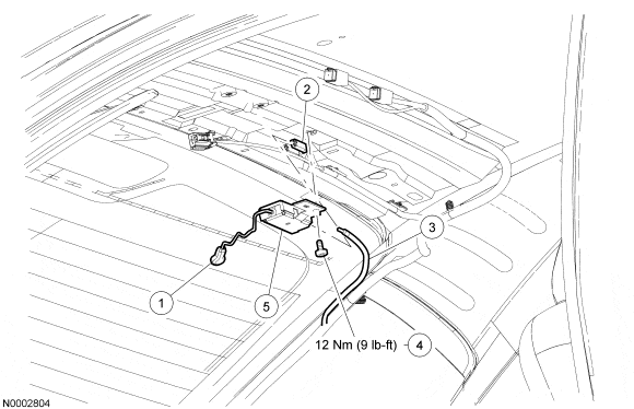

When I bought my 2003 Lincoln Ls from original owner he told me that the FM and AM radio doesn’t work due to a damaged antenna. 8 years later I still haven’t figured it out. Does anyone know where the antenna is and what other things to check out. Thank you.
Sure, The antenna is in the rear windshield. It's some of the lines that look like rear defroster lines, but aren't. The antenna amp is on the inside of the roof at the back window. I think that it has been found to the be problem sometimes.
Thanks for the reply. Would I have to remove the headliner to get to it?
