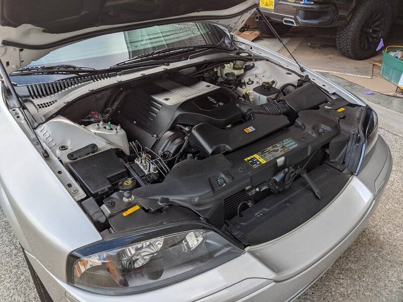

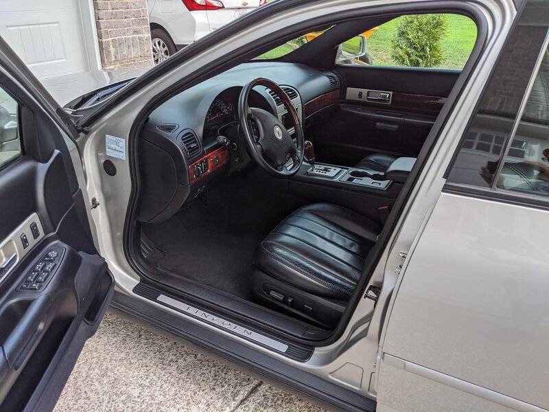

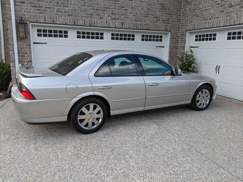

Car is back from the dealership. In ABS module and programing. Had a ton of codes in history that I could not access with my reader. We deleted everything and started clean. So far looks good. Ran it hard yesterday with zero issues. Gonna sell it and move on to a Hellcat before they are gone. If the evil side wins in November, don't think you will be able to buy a 700hp+ car off the dealer floor.
With 54K and all work up to date and over maintenance, it should be a nice car for someone.

That is a clean LS!
