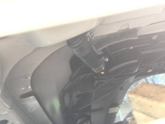

I got crafty and used an old coil boot. The larger side of the boot fit nice and snug over the drain hose, and then the smaller end of the boot fit nice and snug over the drain nipple. I used hose clamps on either side just to be safe, and I also wrapped the hose in some waterproof tape before I slid the boot over it, because that hose has those weird little white things. Didn't want to give water any chance of getting under them and still leaking.
This was the drivers side, the left of the picture is the windshield side.
These pictures look confusing, like where the hell was that picture taken from? Mine was me standing outside of the drivers door, right up at the top edge.
