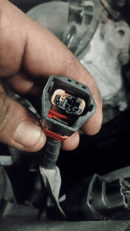

    I was able to get my LS in with the mechanic this week. I linked him to some stuff on here for the AC repair, and he found the fuse to the DCCV was blown.
    Pulled it apart, and sure enough, the plug itself was melted. See pic below.
    Couple of things. First, Ford and their component pricing. For the DCCV, Ford wanted $290 CAD. Ok, maybe for such a complicated device, I can understand.
    Then for the wire, a simple wire harness that has 3 plugs, Ford wanted $370 CAD. OUCH!!!
    Got the DCCV on Amazon, Prime shipping $69, and the wire I pulled out from a scrap 2001 LS for $25. Plugs dont fit exactly between first and second gen (their orientation) so mechanic had to splice the ends off and wire it up.
    So total Ford pricing: $660 X 13%HST tax = $745.
    Total I spent buying from amazon/scrap = $95 X 13HST tax = $107
