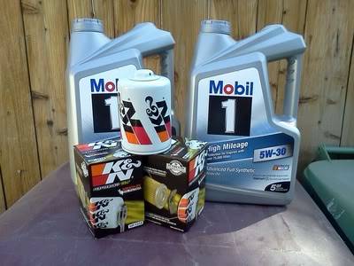

Ive been running the same stuff but switched to synthetic blend and motorcraft filter since its much cheaper and what ford recommends.
How come you using 5-30 weight and not 5-20?
Yeah. That's a bad idea with the hydraulically controlled variable valve timing and all. The higher oil pressure may damage some seals. Besides, I'd want the 5W-20 (or even 0W-20) oil to be sure that the timing chains and tight passages got all the oil they needed.
5W-20 is recommended for all years of the LS, V6 or V8.
(0W-20 meets all the specs of 5W-20, so it can be used instead. It's slightly better.)
5W-30 is allowed for gen I LS. 5W-20 is required for gen II.
Did you enjoy paying 3x the price of what a normal oil filter costs as I do? Also yeah I wouldn't chance it, use the 5W-20. It's more expensive, just like everything about the LS.
I just got my K&N oil filter from Amazon for $11.00. Motorcraft filter around here goes for $8.00. Definitely worth it imo. First time I used K&N and the wrench off nut on the end is a god send. So much easier than trying to find a good angle to get the oil wrench on.
yeah I would go with 5-20 .. just my opinion.

As for the 5w-30 I just grabbed the wrong jug and didnt realize until I had already put it in that the 2nd gen was not as interchangeable between 20-30 as the first gens. Additionally the 115F Palm Springs summers are coming up soon and I figured that bit of extra viscosity couldnt really hurt. Is it really that dangerous to do this?
Next change I'll try to locate some 0w-20 though :)
As for the filters I only paid around 10 bucks each with free shipping from Amazon and I wanted to spoil this car for it's first couple changes lol

First oil change and you used the wrong grade of oil. Way to RTFM lol.
