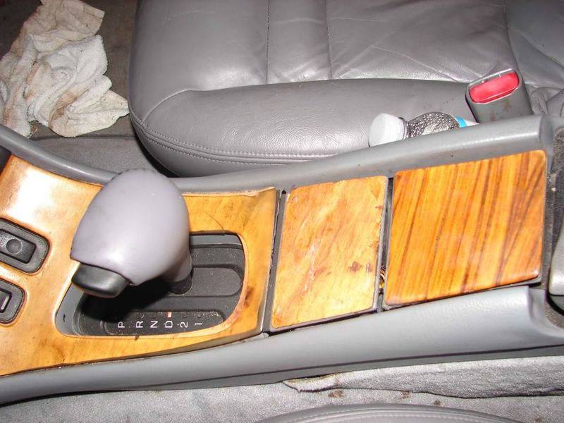

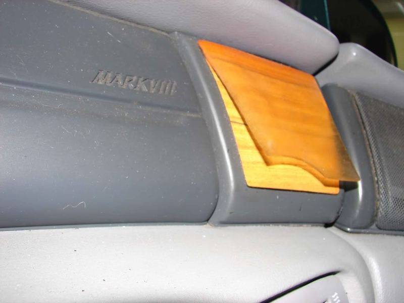

well i have a wood dash kit in my 93. The kit was already in the car when i bought it in 2006. I can say that when it gets hot in the car, like if its been sitting in the hot sun for a few hours, the outer clear part start to warp and sometimes even peel up.
these pictures are the effects from the sun. YES THE CAR IS DIRTY
if any1 knows a remedy(besides ripping it all out) lemme know

any1 have a remedy for the clear plastic part that is peeling away from the wood?
Check with a hobby shop the sells RC Planes, they have a plastic canopy glue that dries clear. Walmart or a hardware store might carry something similiar.
