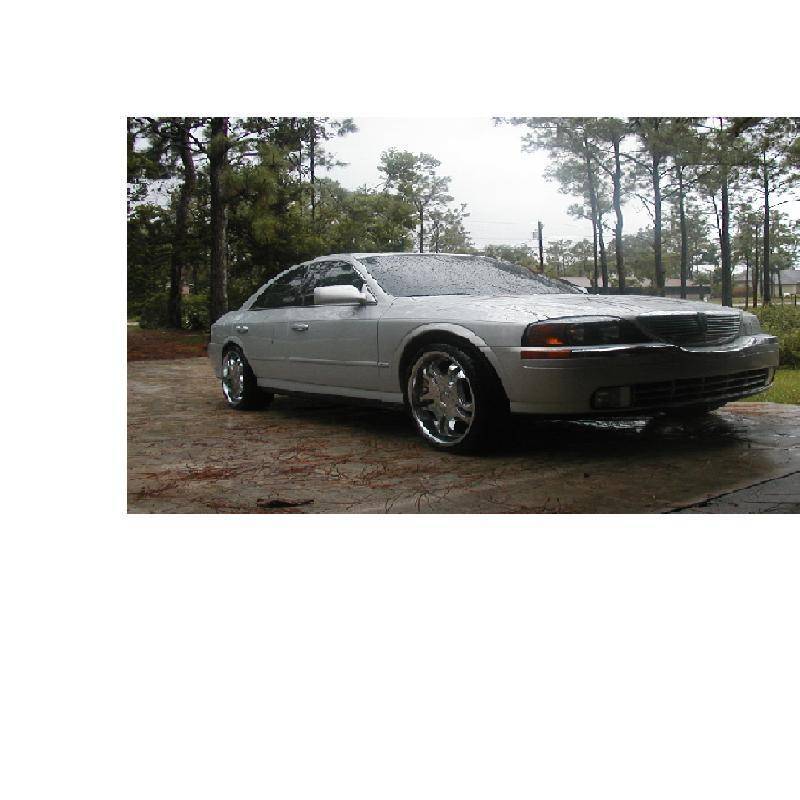

OK.. i went to the tire shop today and had them check the ballancing again they said it was perfect..but they showed me that my rim has a 2 and 3/4 inch circle (forgive me i cant rember the name).. where the rim goes on the car.. and then they showed me that the circle on the car has a 2 and 1/4 cricle they told me i just need a little ring..(forgot the name to but its not a spacer or anything) only 20.00 that will make up the 1/2" difference.
the circle im talking about its right in the middle of the rim and the middle of the the five lug studs.
no not the bolt battern but there is a circle if you take your rims off u will see exactly what i mean.. there is also a circle in the rims that should fit exactly if they dont then the mechanic told me about the centering rings that will fix the problem. These are the best pics i could come up with in this florida hurricane weather.
