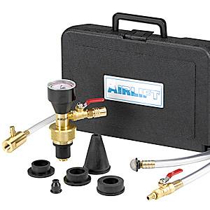

This is what I use on all my vehicles. NEVER had any problems with trapped air after buying and using this. If you have an air compressor, at least 20 gallon, you should be fine. Got my for under $100 on Amazon a few years ago, today probably $115 to $120, look for sales on-line.
Damn! I need this! Thanks

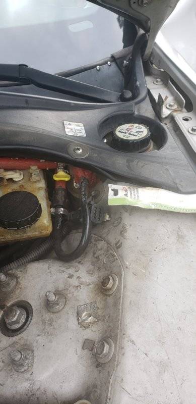

Try running the bleed line into the edges tank. Speeds up burping the system. Bleed line tread M6-1.0 and 1/16-27 NPT fitting in the tank.
