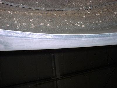

EXPENSIVE and NOT needed. Especially since you will more or likely use this ONCE. Just cut it, cut it right and be done. I cut my fenders on 2001 and they look like the day I cut them.
I'd prefer to use the proper tool if it's only $50 to rent. That baseball bat idea looks like a recipe for noob disaster!
Baseball bats or any other similar solutions work perfectly but may not get you the desired results. I rolled mine first, it still rubbed, then I just clean cut it.
A buddy of mine clean cut my fenders before I got the roller for my LS and it caused them to crack, my guess is because they're aluminum. Anyways, I have one of those fender rollers, I'll lend it to you a hell of a lot cheaper than they will.

You tape it out then cut with a high speed whizzer wheel. No damage.

Also dont cut too far their are spot welds holding the car together in that fender. You can see them in Genos pic. He is a pro and knows exactly how deep you can trim.
I'd just be afraid of introducing too much heat into the paint...

You need a buddy with a rag and a bucket of ice water.
My old man used to braze 1/4s on that way.
Keep the heat away.
I think if you went slow and used a little common sense it would come out fine.
