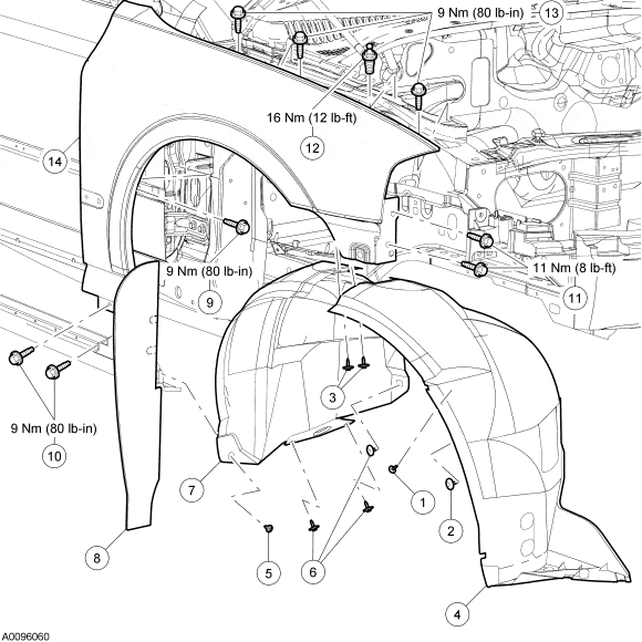

Ok so the door removal is easy enough but the front fenders may be a little harder. Is there any hidden bolts I should know about before I wreck something
2006 Lincoln LS Workshop Manual
Fender
Removal and Installation
1. Remove the front and rear fender splash shields. For additional information, refer to Fender Splash Shield in this section.
2. Remove the bumper cover. For additional information, refer to Section 501-19.
3. Remove the 2 front pin-type retainers and position the front rocker moulding aside.
4. Remove the 4 pin-type retainers and the radiator upper sight shield.
5. Remove the 3 bolts and the headlamp assembly.
* Disconnect the electrical connector.
- To Install, tighten to 6 Nm (53 lb-in).
- If necessary, adjust the headlamp. For additional information, refer to Section 417-01.
6. Remove the 2 radiator grille opening panel bolts.
- To install, tighten to 11 Nm (8 lb-in).
7. Disengage the wiring harness locator.
8. NOTE: Support the hood using a prop rod.
- Disengage the lower hood assist strut.
9. Remove the hood assist strut ball stud.
- To install, tighten to 16 Nm (12 lb-ft)
10. Remove the 2 lower front fender bolts.
- To install, tighten to 9 Nm (80 lb-in).
11. Remove the 3 upper front fender bolts and remove the fender.
12. To install, reverse the removal procedure.
- Adjust the fender as needed.
