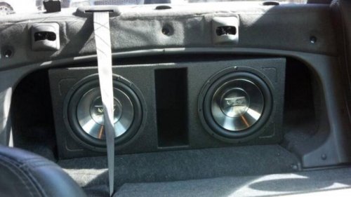

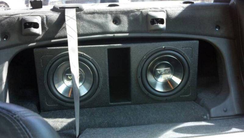

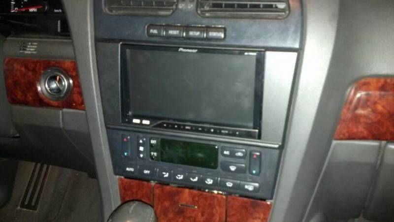

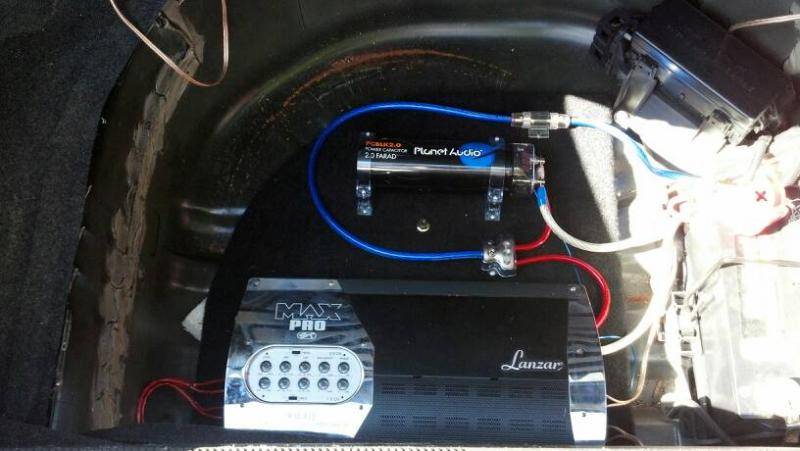

I just did this... I also had the factory 6disc and no subs. There is still a harness that has everything you need in the trunk even though the speakers are not there. The metra harness comes with the adapters and I was able to make it all work. I ran separate RCA's to my sub instead of using the factory connection though.. wanted to use the low input rca on my amp and not the high (which you will have to use if you go with the harness connector in the trunk. Pm me, I will the you everything I ran into making it work. uploadfromtaptalk1398043685640.jpguploadfromtaptalk1398043698067.jpguploadfromtaptalk1398043709448.jpg
