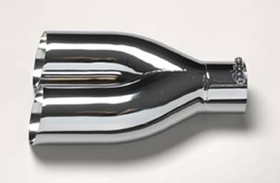

Ive read all the posts on Exhaust tips and I want to get some that go through my rear valance like the LSE style. I know I have to cut the valance to do this, but I noticed some of you running custom 2.5 inch systems, say you have dual Magnaflow tips coming out of the back. I was on Magnaflows site and all I can find are 2.25 inch dual tips. Are there any other places I can find them? I found these made by Hooker (not "a" Hooker, haha) They are 2.5 inches but dont have the rolled edge that I would like. Any other places I can look? Thanks!

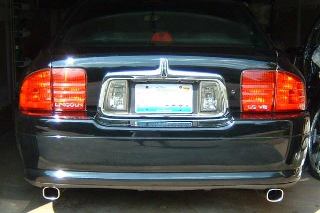

Those look very good. They look very similar to the tips I offer with the LSE body kits.
Indeed they do:
Ken are your tips weld on or clamp on? Whats the ID on those? 2.25" or 2.5"?

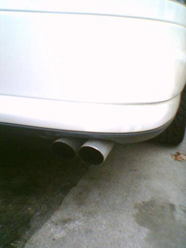

Heres mine.. sorry for the quality.. my tips are the same as the ones pictured above. The last owner trimmed off a piece from the stock real valance and welded them on. *one more thing the tips are chrome just that in the pic they are very dirty.
