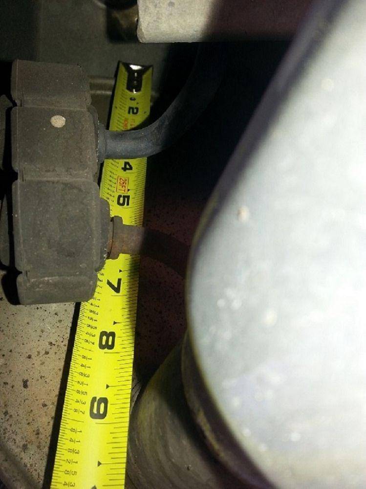

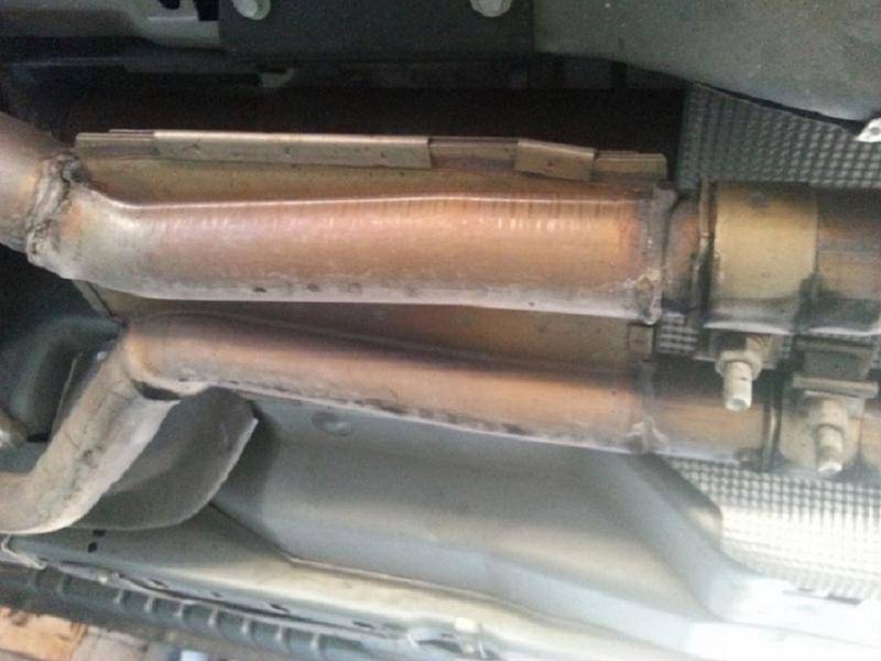

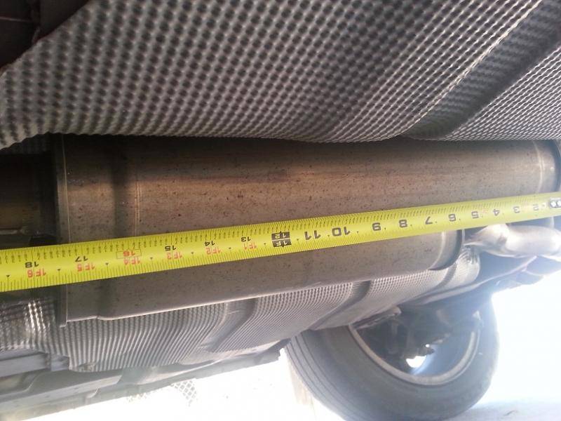

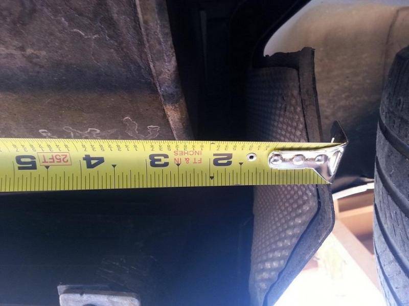

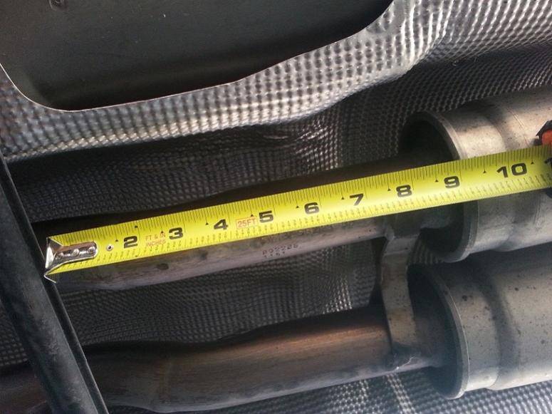

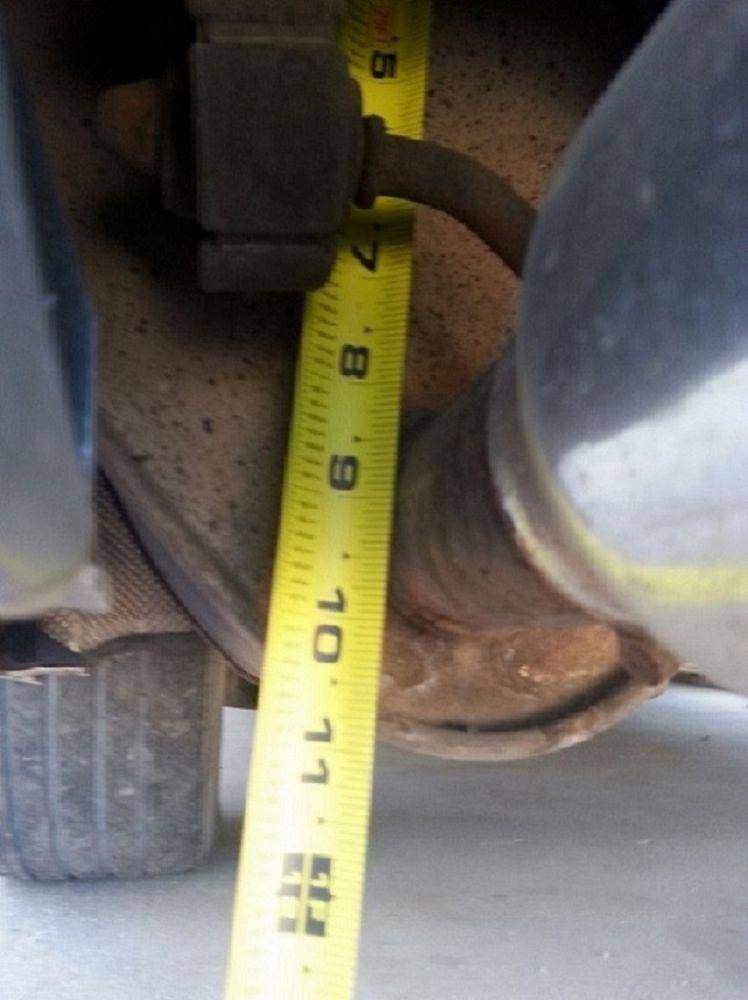

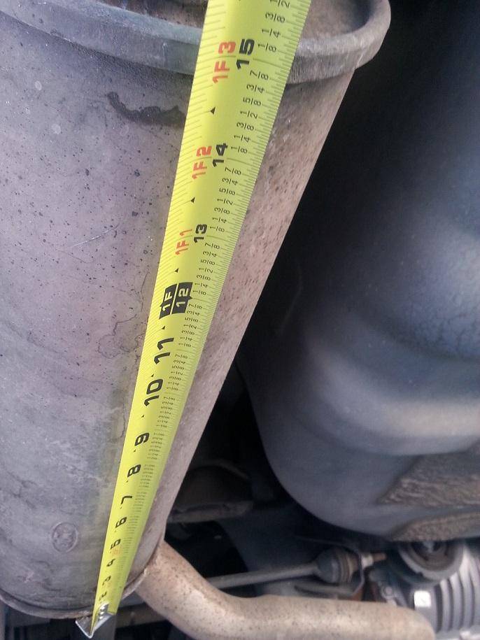

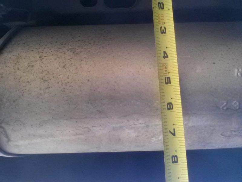

I gather that the factory piping is 2" in daimter. I added some pictures of measurements I took from my LS to get a better idea of what can work. Magnaflow makes a plethora of options to customize different kinds of set ups. I added a couple of different pictures of different mufflers, also part numbers and muffler measurements. my initial plan was to install an 2.25" X-pipe(pn 10790) as soon as both exhaust pipes came close enough together before the resonators, then install a medium sized oval muffler in place of the factory ones(2.25" oval muffler pn 12255). That plan I decided to scrap and I think I'm gonna end replacing the glasspacks with a dual 2.5" inlet/outlet X-Core muffler(pn 11386 20" length) as a resonator, and then the Mufflers at the back where the factory ones go(pn12256 18" length). A little easier on the wallet and a quieter option too. I'm going for the quiet exhaust, if anything the slightest decibel louder than factory, but I'm only looking for better flow but keeping as quiet as possible.

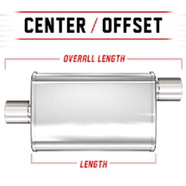

So Magnaflow muffler part numbers are as follows:
Center To Offset Muffler 5x8" oval, 18" Body length 22" overall Length
2.25" in/out 12255
2.50" in/out 12256
*this particular muffler in my opinion would be the best fit to replace the factory mufflers, tight fit but should work(in theory).

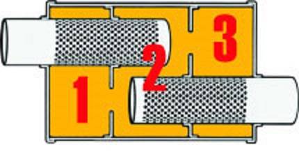

*A quieter option would also be Maganflow's XL series muffler, these are chambered mufflers not straight through, they claim to be the quietest magnaflows around. Not sure how much flow would be restricted over the regular straight through mufflers, but its probably A LOT better than factory either way.
