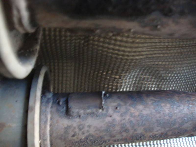

For anyone who has the metal grinding noise from under the car that comes and goes with engine RPM (mine is only after it warms up) I *HOPE* I just resolved mine. I yanked off all the heat shields I could get to and it was STILL happening right at 2k RPMs and a little at 1,500. As I was putting the largest heat shield (under the resonators) back on today I heard a clink.
There are 2 braces (more like thin straps) shoddily welded between the pipes. One side of one was broken and sounded like a great candidate for the noise when I moved the pipes around. I ripped the broken piece off and buttoned everything back up. I haven't had a chance to test drive it since my wife is out with both car seats and my daughter is home with me.
I'll report back if it worked. If it didn't I'll just start binge-drinking and get back to the crying.

Ok this
came from here
just in front of the resonators. There is another one after them.
I drove to church and back today and the noise is...GONE! :N
