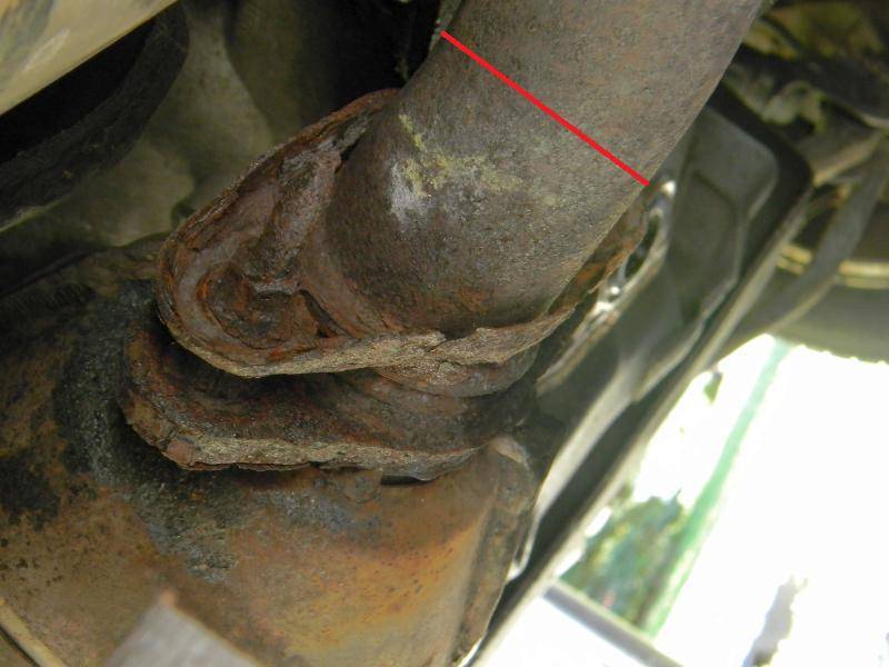

Assuming that the cat that's part of the driver's side exhaust manifold is worth saving, here's one way to attack the problem.
Cut off the down pipe close to the failing clamp (red line, 1st picture). And I'm certain that you'll also have to cut both exhaust studs (between the flanges) in order to remove the rusted pipe.
Then cut the rusted studs flush with the flange on the cat, drill out, and install new studs.
Finally, weld on a new flared down pipe and flange to replace the piece cut off in the first step.
Any competent exhaust shop should be able to do it.

That is exactly what I had to do and other then the shop not making the flair big enough it has worked out well.... I don’t think it has been said yet but when reassemble happens stainless hardware is your friend.
Thanx guy's! This is something I haven't considered. Cutting off old flare and welding new flare, bracket and bolts in. I will see how this works out 1st.
