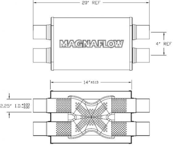

The 3rd cat/resonator is to reduce noise for the cabin. You could X or H it there if you want to hear your pipes more, or use a DIDO muffler to quiet it more
8357d1246476498-magnaflow-4x9-dual-inlet-dual-outlet-muffler-gets-rid-rasp-magnaflowxpipedrawing.jpg
"That will work" leaves that question wide open.. it depends on the pipes.
Every extra bend makes the exhaust quieter
For cross systems, an H will be louder than an X, a single X will be louder than 2.

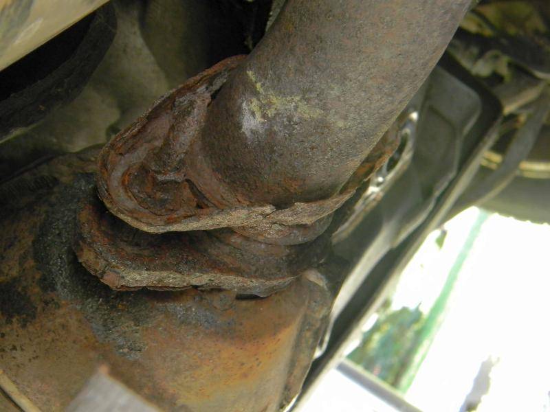

I put it on a lift today.
This is what I have, all 3 cats (good), Res (good), both muffs (good). Pipes all good.
But the connection (the thing that holds both pipes together) between the drivers cat and rear pipe is toast!!
What should I do with this?????? The guy told me he wanted to cut it off and weld a pipe in there and I told him NO!! Then I left.

Where is the leak coming from? Is it on the cat side of the flange or the pipe side? It looks like there's a hole in the cat right before the flange, if that's the case there's really not a good way to patch that and have it hold, I would just replace both front cats if one is bad..the other will probably end up rotting through eventually anyway, and then just do your exhaust of choice after that.
The cat is good, the bracket (flange) thing that holds the pipe to the cat is rusted away and it's leaking where the pipe meets the cat because the bracket isn't holding them together anymore. Is there another bracket that I can put around the pipe and screw it back to the cat bracket? I don't think welding them together is a good idea. Don't you have to drop the exhaust to get to the gas tank or the drive shaft? I think the rusty flange bracket thing was put on the pipe before it was flared so it can bolt to the cat. Any suggestions for holding the pipe tight to the cat if the clamp on the pipe part is no longer uasble?

This isn't my manifold, I should have taken a pic a little farther away. It's the connection behind the drivers side cat to the pipe. (pipe comes down from manifold and is welded to the cat, on the other end of the cat there is this connection that bolts to the pipe). Right under drivers side floor board. There are 2 bolts that bolt the pipe to the back of the cat. I was wondering if I cut the 2 bolts off and removed the rusted pc that holds the pipe the the back of the cat (which is no longer holding anything together), is there another kind of clamp that I can put there? Something that I can slip over the pipe to bolt it to the cat, since the pipe is flared to match up with the back of the cat.
