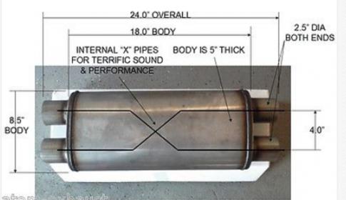

for the Ivory car, thinking about getting the factory exhaust modded to 2.5" true duals; the brown car has an un-muffled x-pipe at mid-body then 2 MF muffs at the bumprer, it sounds great; for the ivory car (which sits lower) I'm thinking of doing a muffled x-pipe at mid body then go straight to tips at the tail(s), iirc Don Pfau did it that way....will a 24" overall length fit? something like this

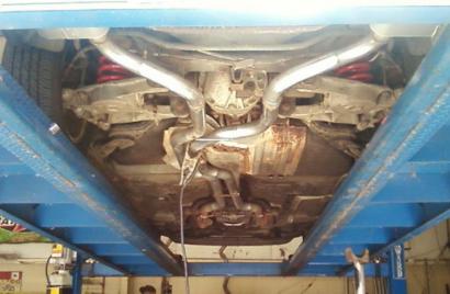

here's the brown one, before the x-pipe was put in (sounded awful with no H or x-over)
what size/model MF 2 in 2 out muff is that? I/m paying a shop to provide the tubes and do the remove/replace. I just have to provide the right muffler/tips
will the setup I describe be obnoxiously loud in the cabin? (no muffs at the rear bumper, just the x muff at mid body)
