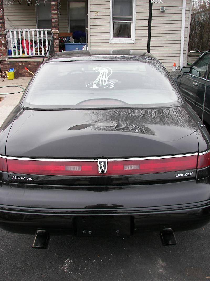

So I just got her back from the shop yesterday.

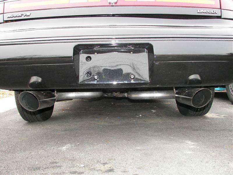

They ended up blocking off the egr, cutting out both cats and moving them downstream, 2.5" dual all the way into the 2 cats right before the xpipe, then out the x pipe into the 4" tips.

Sounds good! Abit loud for me, but that's what you were after, right?
Can those tips be put on further or cut? They seem to stick out beyond the bumper a bit too far.Those pipes seem to be closer to the center too, did you want them like that or did they just do it that way?
While I agree that the tips stick out too far for my tastes, if it was what you were looking for then awesome. I do like the rumble! And let her keep hatin'!
Sounds pretty good.... I'm not a fan of the tips... but to each there own.

It does look a little close, and a little more out expected, but for $450 for the entire job I won't complain!
No shop around here gave me a quote better than 750, so I'll take it.
