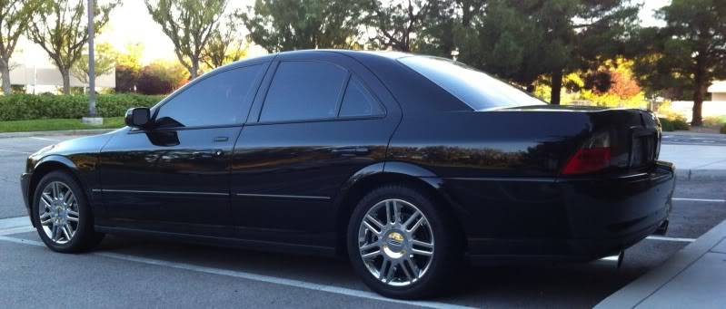

Have you ever posted pics of your car. I'm looking at your sig and it looks awesome. Those gen II wheels in chrome. Mmmmmmmm looks dead sexy.
I don't have any recent photos with nice backdrops or anything just the one in my signature. I need to find a nice spot to take some better pics. Here's a bigger pic of the one in my sig.
