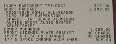

Mine came from the factory with euro shocks. I think it was part of an upgrade that you where able to get for a few extra bucks.
Don't know how that happened. If you're talking the "premium" with the non-SST shifter, chrome on the bumper and basket weave seat inserts, then the shocks are sport shocks. It was basically a non-sport LS with the sport suspension. Lincoln didn't put the euro shocks on any domestic (or Canadian) LS. They are only in the inventory because the LS was supposed to be sold in Europe, like Quik said.
Any of the "Euro" shocks would have to be 2+ years on the shelf by now. Any idea if there is a shelf life for Shocks?
Don't know how that happened. If you're talking the "premium" with the non-SST shifter, chrome on the bumper and basket weave seat inserts, then the shocks are sport shocks. It was basically a non-sport LS with the sport suspension. Lincoln didn't put the euro shocks on any domestic (or Canadian) LS. They are only in the inventory because the LS was supposed to be sold in Europe, like Quik said.[/QUOTE]
Well here's a copy of the window sticker that says it came with euro shocks.
The car is a sport with SST.
The car is a sport with SST.[/QUOTE]
Back to my question, How is the ride with the Euro's? Can you compare to the sport or base shocks?

I think that the ride is firm. I don't have anything to compare it to but my previous rides. You probably don't want them if you don't want to be shaken up over bumps. Wouldn't be a good choice if the roads are crappy. You really feel the road.
