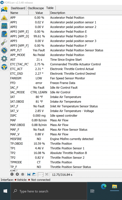

Guys im stumped, i added to my collection a beautiful silver birch gen2, which has its common mishaps, some i never experienced with gen1.. ive searched evereywhere if this has been covered lmk ill remove, left the airport the other morning in new orleans, all was well til it wasnt well, etc failsafe no throttle while i was eating lunch sitting while idling with ac. rewind couple months; the car would randomly, harshly accelerate/deaccelerate/accelerate so on.. from a stop, like it had bouncing airbags kind of harsh. ive noticed last week or 2 that thepedal wouldnt be acceleratinng as it should but only lasted couple secs of glitch randomly. i worked on it for hours, at one point i was abble to crank and idle for ac, still failsafe was on after numerous battery disconnects.
I put a nnew throttle body on, let idle for 20 mins still nothing rresponsive from pedal except slight increase, tho it moved at startup to allow the warm-up rpms, i confirmed the throttle is movinng on its own inside the TB. Changed TPS too, cleaned MAF, changed fuel pressure sensor, still nothing helped. could the pedal itself be the issue here, do any of you ever replaced the physical pedal? And why idling wqould it just decide nnows the time i tear up? Seems forscan doesnt evenn see the pedal.. anny help or insight is appreciated, thanks.

Has no one on here have a clue about this? No one? Has anyone ever changed the pedal? I change pedal today and it ran fine for a few mins then boom it went back into failsafe mode. I would appreciate any guidance you have even if it doesn’t help, bc nothing I’ve done has helped more than 5 mins. My dad is barely alive from a brain aneurysm and a stroke 6 hours apart and I can’t even get to hospital to see him, anybody got any suggestions? Could it be a pcm fault? Nothing changes if I unplug the fuel pressure sensor or the tps and they both been changed along with the throttle body and pedal. Cleaned maf, checked all the new coils. Plugs are new too and no oil was in the hole so I didn’t pull them out. Forscan pulls now every code possible for throttle issue but doesn’t pin point its like 20 of them ending in -FF.

There are not actually a bunch of codes there.
The HVAC codes can be ignored because they aren't any part of this.
All the other codes there are really just a result of two codes, P2121 and P2122. Run the pinpoint tests for those two and the problem will quickly be apparent. Shorted or broken wire, bad pedal assembly, or bad PCM.

Battery is new, connections are fresh, checked all the wiring and watched probably hours of live data to pinpoint it down to a 5-9% surplus of the threshold for the stepper, TPS and the gas pedal/ butterfly assembly. I found the problem.
