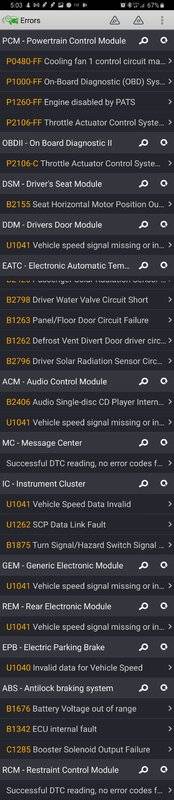

Cars been running great but now all of a sudden it went into etc failsafe, turns very hard, says check advance track, service park brake, here's the codes. Sounds like possibly the coils, but there's a lot of codes so maybe something else, went from running fine to next time I started it instant etc failsafe, hard to turn, any other ideas? Thanks.
Drove about a mile and notice speedometer doesn't work now and it said check transmission to the list of things on the screen. Assuming due to no speed input so perhaps that's the reason more than coils, getting a few more than normal misfires also, so I prolly have 2 problems, ha.

I have 3 abs codes but none talk about wheel sensors. Looks a little more serious than that maybe. Got b1675 b1342 and c1285. All listed in screenshot in first post. Says ECU internal fault, battery low voltage and booster solenoid output failure. Thanks

Seems like you have an FEM communication issue too... which may (also) be power related.

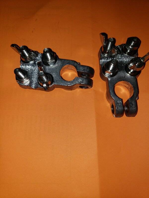

Did you check the short battery ground cable going to the body? I had the most dash lights illuminate with rough engine operation all in a mile.
I found the body ground 6mm bolt was loose and corroded Fixed it with eighteen feet of #4 welding cable from the body ground to bottom stater bolt. Problem solved. Still had the original starter when I switch engines. Also replace the stock terminals with NAPA truck type with stainless hardware which is a little more insurance for no long term worries.
In the trunk? Yea, looks good, nothing lose. Battery new 6 months ago. Mine runs good, just in failsafe mode, won't go over 2000rpms, have a few misfires on the monitor but you can't tell by listening or driving it.
You have a code saying the ABS module is bad, and you have the symptoms of a bad ABS module...
Yeah with all it says and how it acts I'm thinking you're correct on that. It was fine the previous trip, must've failed on startup, didn't even make it out of driveway before it went to limp mode. I guess I try and find one of those and see what happens. Thanks.
It needs to have AdvanceTrac, if you have AdvanceTrac (sounds like you do). You'll have to run a calibrate routine on it (Forscan can do it).

can you tell the difference by looking at it, like say if I went to a junkyard to get one? Seems like they're about 430 bucks new and I'm sure they're not returnable so I ain't going to drop that kind of cash on a hope and a prayer, lol, thanks
Pull one from an LS with AdvanceTrac. AdvanceTrac button has wavy lines. Traction control button has a spinning wheel.
