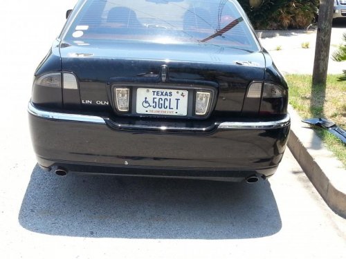

and finnaly today 3-9-12 i painted the chrome surround on the trunk
this pic is prior to the fender bender
and chrome painted
ill take better pic tomorrow when the sun comes up

Nice LS, I really like what you did with the back tails/rear surround. I plan on doing that myself in the near future. What sort of paint did you use on the chrome?
dupli color perfect match black, about 3 coats after wetsanding the chrome , and using 2-3 coats of dupli color clear coat and finnaly a polishing compound for good measure lol
exact same procedure with the tailights except obviously instead of paint i used Niteshade on the lights lol
Looks good. Nice job on the repair. Nothing good ever happens at Walmart. I like your enthusiasm.
rear surround in the daylights , gotta say thing looks nice :D
5 bolts on the back side , 2 are the bolts to the lights and one right behing the emblem the other two at on the bottom corners , then just give it a nice tug and bam it comes off , just be careful with the plate lights they dont have much wiggle room

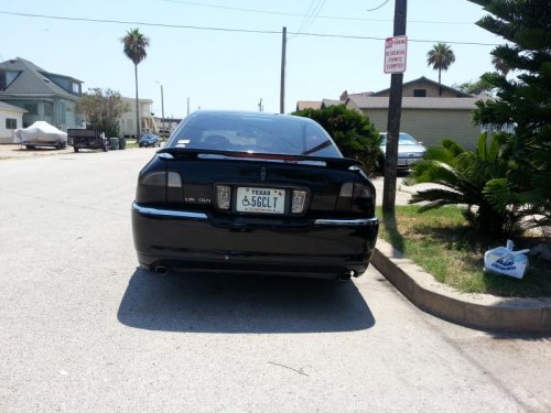

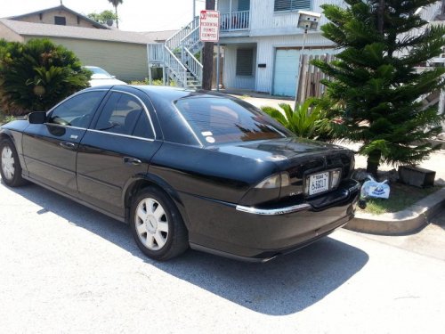

so been a while since i updated here, so i guess ill add something

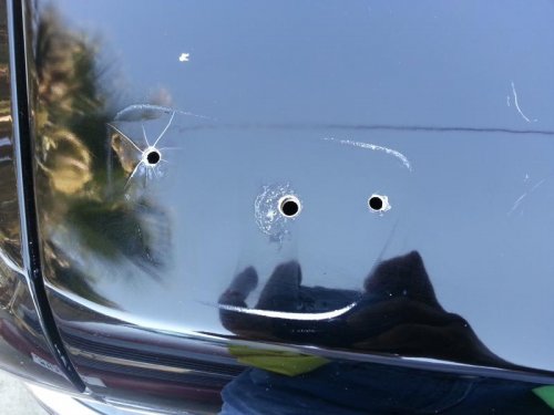

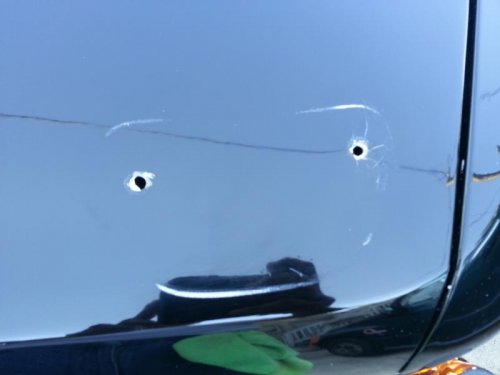

as i mention in the "What have you done to your LS today" thread , i took off the Spoiler, and well its bittersweet
cleaned as best as i could and well...... scratch galore , :( :(
20130817_163524.jpg20130817_163520.jpg ;_;
for whatever reason whoever installed this , added an extra hole for safe measure to the left side >.>

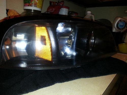

well debadged it earlier, (no pic )

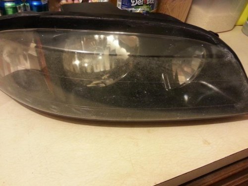

and cleared my headlight thanks to four_t_one and the awesome link he passed on to me
before

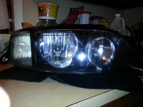

front, seemed like the corner was still foggy dont know why it showed like that on pic
but here is a corner shot

yeah i think ill bondo it or just pull the trunk from the car at my sisters lot
as far as selling the spoiler, well its pretty scratched up , some very deep scratches on it, and the LED light on it has some chips around the edges like if someone tried to break the plastic cover, it was never connected since i bought the car so quite frankly i have no clue if it works
Looks great, been thinkin about pullin my spoiler too but prob gonna have the same issue so it stays for now, want to plasti dip the whole car in the spring so maybe then.

next things to do it eventually bondo the holes on the bumper (another new thing for me)

Looks better without the spoiler. If you're looking to fill those holes on the cheap (and I'm not by any means recommending this), but I've heard you can hot glue a dime (or something) from the inside to block the hole, tape it off on the front, and then use your favorite bondo or JBweld to fill. Sand, prime, and paint and you're good to go. Black is a good color to hide the imperfection and most people wouldn't notice unless they were looking for it.
If you didn't already 'Helmsman' urethane the headlights, it would probably take care of any left over swirling
