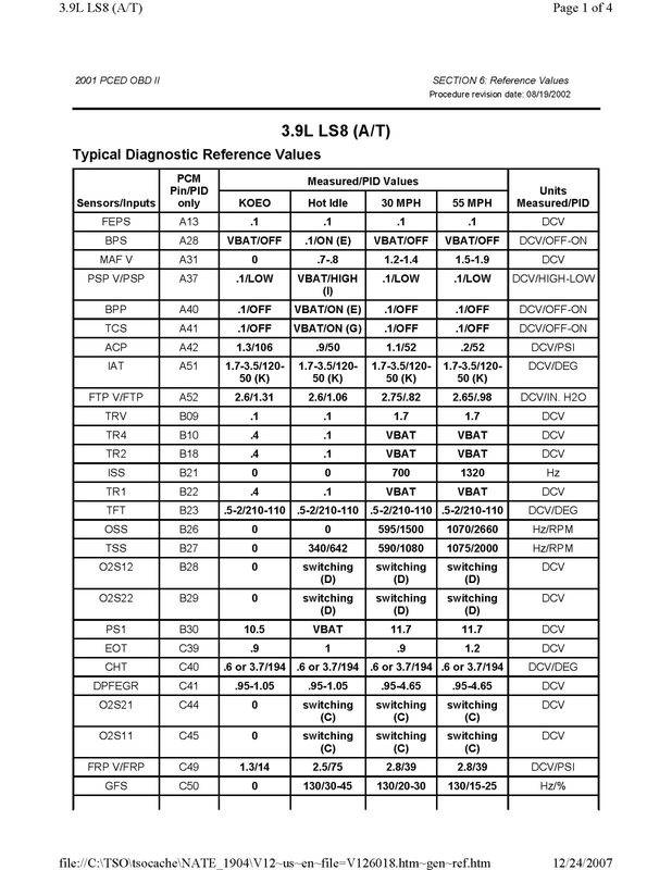

Values:
wow. i wouldnt know where to begin with a multimeter. can i just take it into my dealer and have them look at it?
