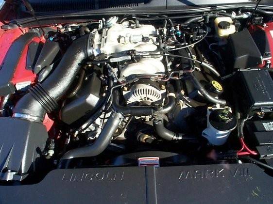

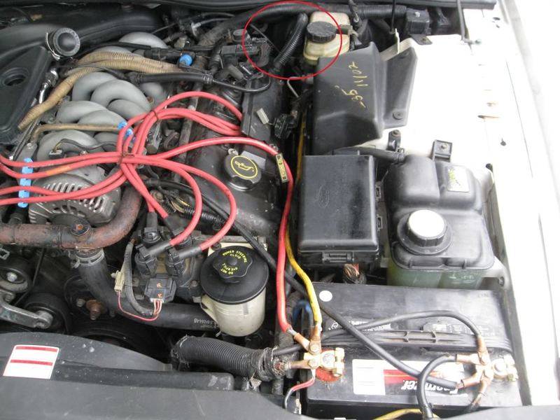

On a Gen 2 intake, the IAC is sticking right out at the top. On a Gen 1, you probably won't find it but it's in the rear passengers side of the intake. Many more differences but there is no Gen 2 from the factory with a Gen 1 intake.
So if its an early built mark VIII 2nd gen it could have the 96 intake?
no.
How can i tell?
2nd gen. throttle body right on top.
1st gen. (ignore the red circle.) throttle body in the very back, snake tube intake style.
