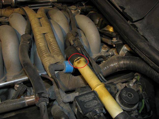

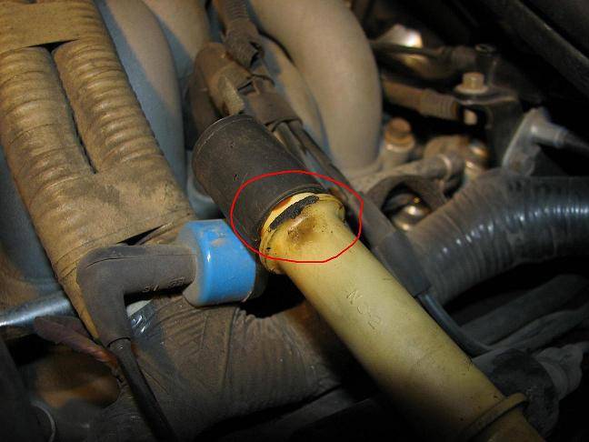

Boots and Burnmarks
I guess my first question is if these are boots and would these burnmarks cause my engine to idle poorly and have a vibration??
Hmmm, thats a Gen I, no COP or boots. Those are just regular wire sets, and BOY do they look spent. I would opt for replacing the set of wires. Cost, about $80. Look at summitracing.com You will want 96-98 Cobra wires (i think, anyone have the summit part #?)
