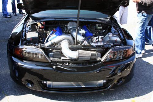

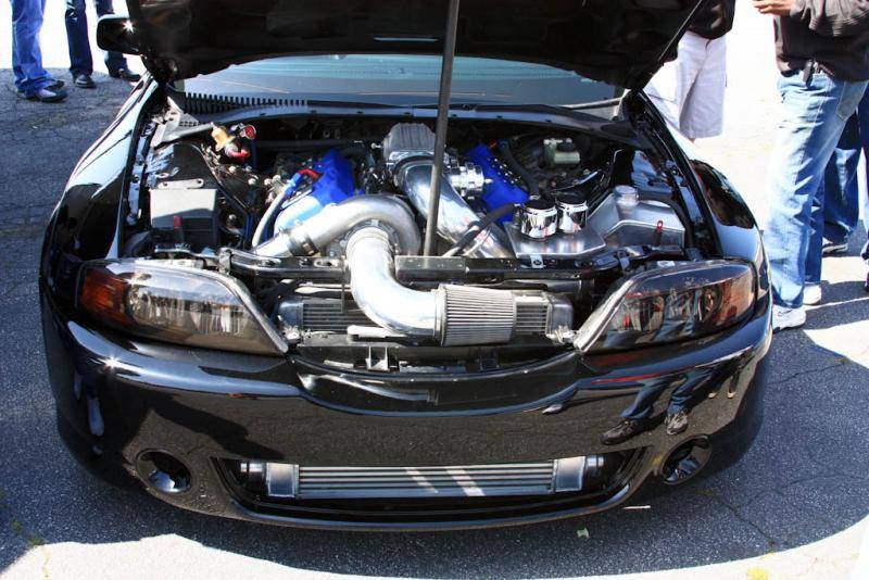

the DOHC build (upper pic is DOHC) will be a can of worms. not for the faint of heart... that'll be a tight fit.
a SOHC build (like the lower build) will have more room,the heads are smaller and everything is just a little less complex, and has been attempted by a select few here on this site. i haven't seen one start yet though... (did i miss it?)
nevertheless, it can be done. someone even used an old windsor 5.0 and a t5 trans. that one did run. there have also been a couple good running chevy LS motor swaps as well.

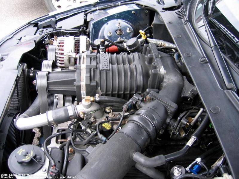

If you can still find it, look for the One Lap of America LS. Ford engineers (who had access to all the stock programming) shoved a 4.6L engine into an '03 LS. They never could get the electronics to work right. They also had a cooling issue they, AFAIR, couldn't really cure. And the guy that put the LS engine in also had to have custom, stand-alone gauges (speedo, tach, fuel level and water temp) as the factory set wouldn't work (electrically). That car has also had more owners than NObama has lies!

that is the One Lap of America LS Ford campaigned in i believe '05.
http://www.test.llsoc.com/OLOA/2005/?page=images
If that's the case it's no wonder they couldn't keep it cool. They added a larger supercharged engine to the car, and it looks like they used a one core radiator (can't tell for sure on it) and then used a parts store electric fan to cool them down. That fan looks like a universal 500CFM job from the looks of it, which is woefully inadequate for the job. They'd have done better using a Taurus SHO electric fan for the job with a 4 core radiator even if it meant modifying the rad mount to mount the radiator a little closer to the bumper. Over in the V8 S10 world they use the Taurus fan to keep their trucks cool, with just as tight an engine bay while running high HP large cubic inch smallblock Chevy engines.
