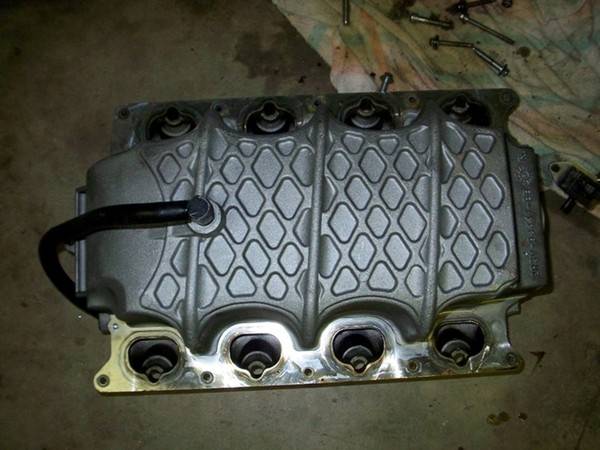

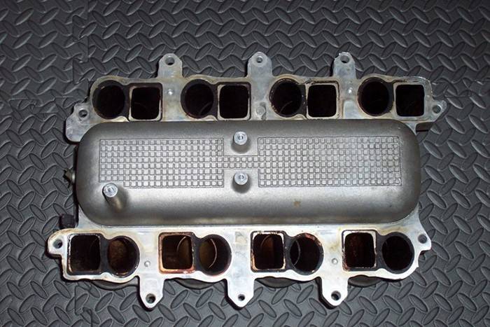

a 96-98 Cobra intake will NOT work.
a 99 and up will.
The intake ports are COMPLETELY different.
The intake in the top picture is a 96-98 Cobra unit.
The lower pic is actually the lower intake from a terminator, (same port setup as C heads.) You REALLY need to search around the forum here, and get a feel for what you are asking.
