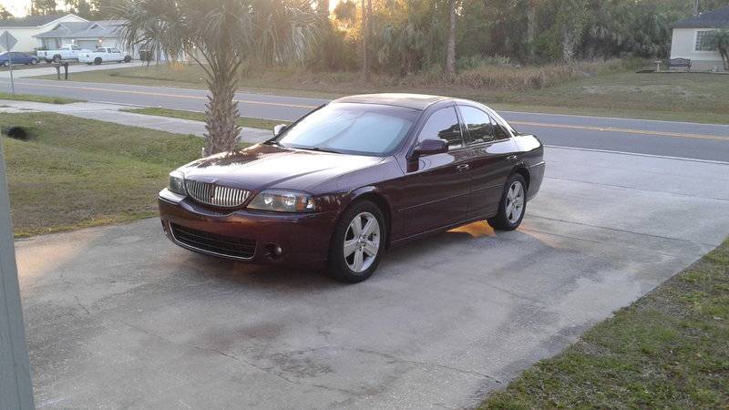

Hi. Newbie from Palm bay florida here. Bought a 2006 Lincoln ls v8 3.9l sport. I am about to tackle all the sucky plastic parts LoL. If I run in to trouble it's good to know y'all might help! Thank you and God Bless
