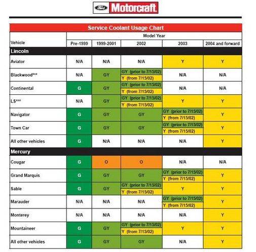

Guys, I just got done changing out my DCCV module and swapped out anew belt since I got most the front end tore off. I've got an 06 Gen II V8 and the manual says to use Motorcraft or equivalent brand coolant (yellow color) when refilling. I went to autoparts store and the tech guy points me to this brand called Zerex G-05 50/50 but the color is orange. Not sure if I should use it. Anyone here refilled their coolant with different color?

In the alldata it just says to fill it with the same color. It gives you P/Ns and names but its motorcraft specific stuff you more than likely won't find in your parts store. As long as it's the same color as your old stuff you should be fine.

Ok, I did go to the dealership yesterday to ask about a full flush and had a long conversation with mechanic and he basically told me some good and bad that goes with a full flush, mostly bad. It was enough for me to reconsider doing that. The bad mainly being that my vehicle already had 75K on it and by doing a full flush, it could end up causing small leaks in seals because age of vehicle. He said best thing to do is buy a gallon of the concentrated Motorcraft Gold coolant and refill it and that's what I ended up doing. I also just ran across a new thread this morning and thank god I didn't do it:
