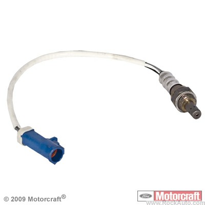

MOTORCRAFT Part # DY1034 {#5W6Z9G444BA, DY1013} Heated
XR3F-9G444-BA; Downstream Rear
http://www.rockauto.com/catalog/moreinfo.php?pk=951642&cc=1373903

That should be the driver side rear O2. Seems like there's quite a few of us with the low circuit code now...hmm.
Bank 1 = Drivers side.
10-4 thank you for your help.
In the UK and Japan. Over here, the right side is the passenger side and is bank 1. Bank 2 is on the left side, which is usually the driver's side.
Bank 1 is cylinders 1 to 4, and bank 2 is cylinders 5 to 8 (or 1 to 3 and 4 to 6).
back to the passenger side, thanks jolinc01!
this is what I first thought to as I recall changing out coils when I had a problem on cylinder #3 which I thought was on the passenger side.
So an easy way to remember this is to stand in front of the motor and read left #1 and right #2 (read left to right pages like a book)
I may have to affix some labels under the hood.
thanks Joegr!
Hmm now I need to get under mine, swap the 2 rear O2 sensors, and see if that fixes my light then.
