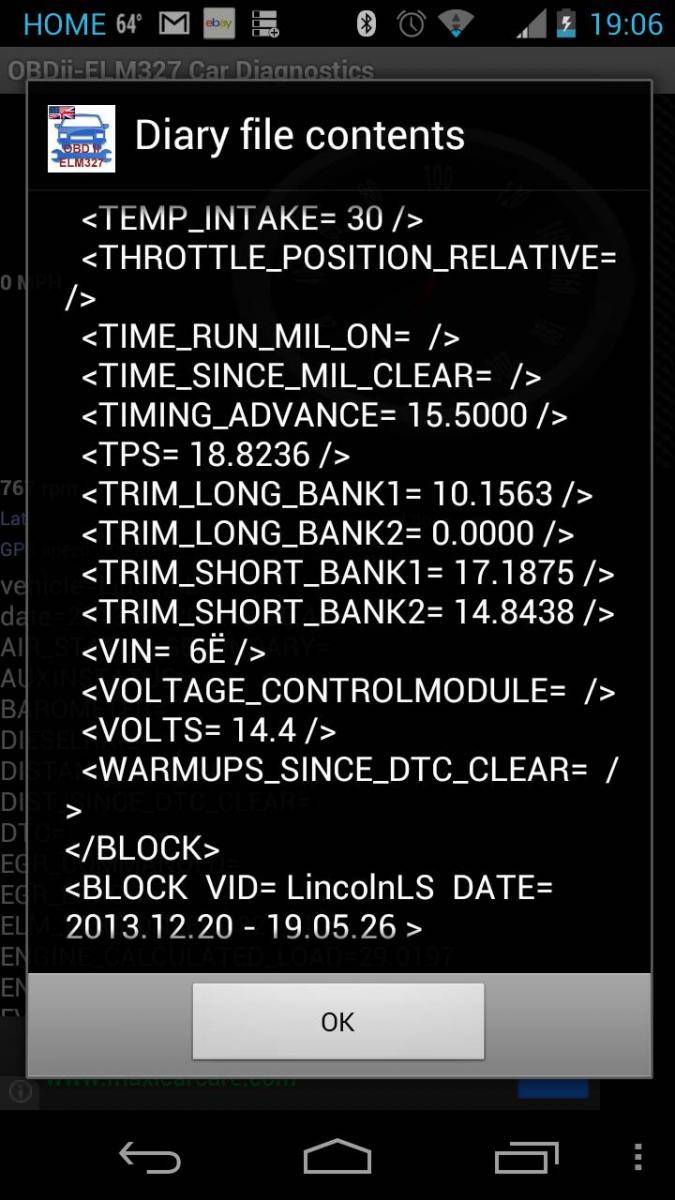

OK, notice where the o2 sensors are listed in the screenshot, is that an indication of why I was getting a P0430 code? Or am I reading it completely wrong.
LT and ST Fuel trim on bank 2 are out of whack.

Yeah, my upstream o2 isnt reading at all. Got the part ordered and en route as we speak.
Part or parts? It's best to replace them as pairs, because both will have been in the same amount of time and thus will have the same amount of wear.
If I could afford it I would. I'll have to buy one this week, and the other one next week. Sucks not getting holiday pay and being off work for 2 weeks :'(
