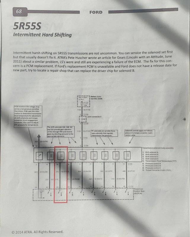

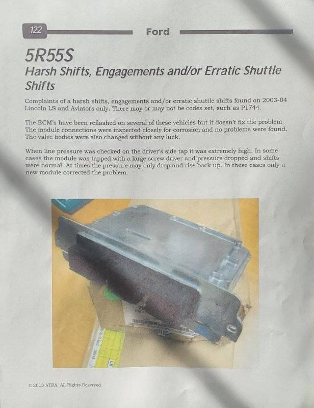

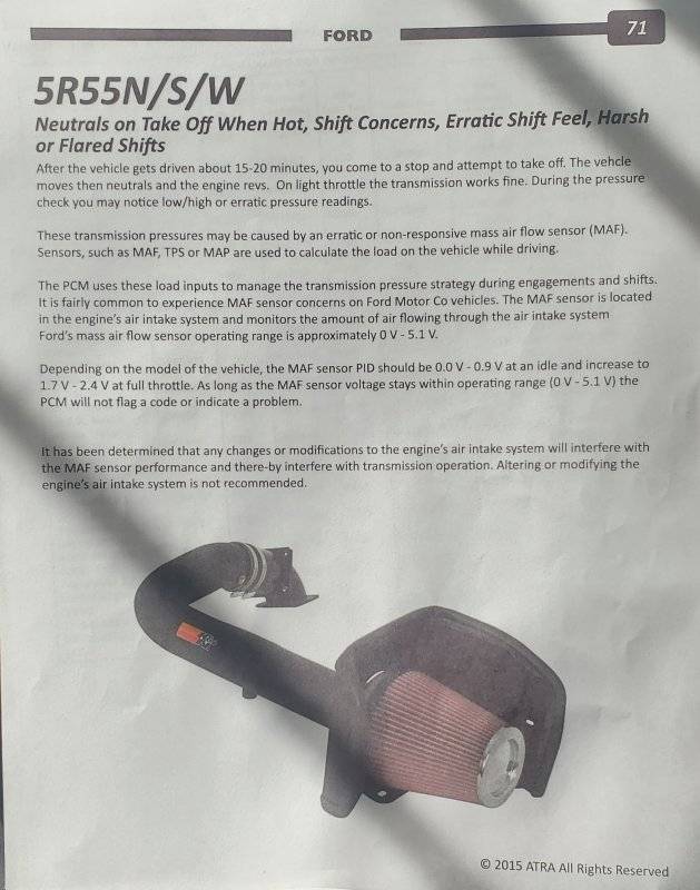

I had the solenoid pack replaced and the issue is unchanged. The reputable tranny shop who worked at ford dealer in early 2000's thinks its thr PCM still. Even after I've had it repaired twice and replaced with one by Flagship 1. It wasn't cheap lol. Still trying to figure this out. He thinks it's the B solenoid chip inside the PCM. Here's some photos of some literature that he gave me.
