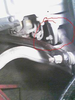

I want to make sure I install these correctly. The bolts replace both front lower control arm bolts and the washers go on the outside of the frame (circled in pic). Correct?
Hite, I used your pic from Car Domain, hope you don't mind.

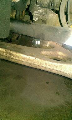

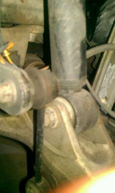

Got you a few pics....taken from the Driver's side. Wheel turned all the way out and pic taken looking in from the front end of the car. Needless to say, but just in case, it is the shiniest bolt in the pic. Other bolt went directly into the bottom of the lower strut mounting point.
Gotcha, thanks for the pics! I was having trouble figuring out where the other bolt went, the one that goes into the lower strut point. Makes more sense now.

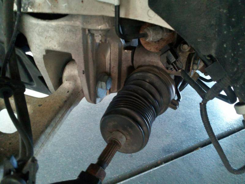

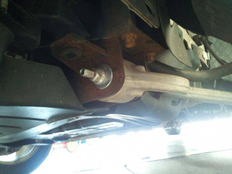

I had a place install the kit since I wasn't sure I could tackle it. They had to drop the steering rack to remove and install the bolt next to it, closest to the firewall. The other bolt installed in the front lower control arm.
