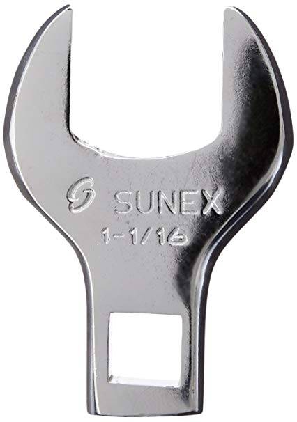

I've been eyeballing a 1 1/16" crows foot for a 3/8" ratchet for this purpose. Of course, I had to use the crescent wrench this time...again!!! I was considering shaving down the sides of a wrench to get a little more room. As you said, it shouldn't be on there really tight.
